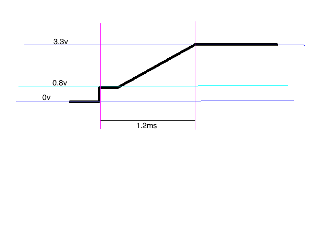

So I am looking at the PORZ pin signal - this pin is driven directly by a TXB0102 with a 100K  Ohm pull down - there are no ther pins connected to this signal. The signal out of the level translator looks kind of funky and I am wondering if the processor is able to read the SYSBOOT with this waveform. I have attached a drawing I made of the signal (can't get a scope shot here). It appears that perhaps the processor is grabbing and controlling the PORZ signal once it hits about 0.8v. The signal into the TXB0102 has a nice clean rise.
I have seen this on other processors like the PIC's but I can't find anything in the documentation that says it does this.
Any explanation as to why the waveform would look this way and would it be causin me issues?

    The TXB0102 has very low output drive strength (4kOhm output buffer provides <100uA). Try removing the 100kOhm pulldown or else replace it with a TXS0102.

  • The PWRONRSTn terminal on AM335x is an input  so it should not be clamping the input signal if VDDSHV6 is within the recommended operating range of 3.14 to 3.47 volts.  This input is not fail-safe so the maximum input voltage is (VDDSHV6 + 0.3 volts).  Therefore, it could be the AM335x device if VDDSHV6 were only 0.5 volts while the input is clamped to 0.8 volts.  Check the supply voltage for VDDSHV6 while the input is clamped to 0.8 volts.
    I suspect this being caused by the auto-direction detecting level-shifter and you would still see this if the processor terminal was disconnected.

  • Turns out that the 3.3v was not quite stable which was causing issues. However I am see ing a new issue.
