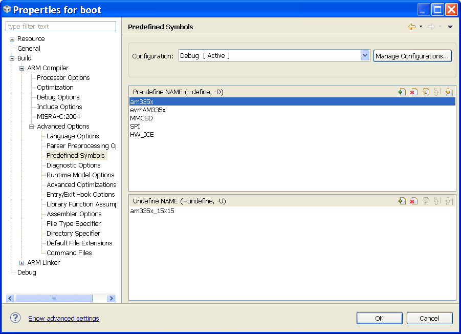

  • It was related to some preprocessor's defines.
    Setting project's defines this way corrects the problem:
