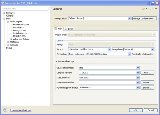

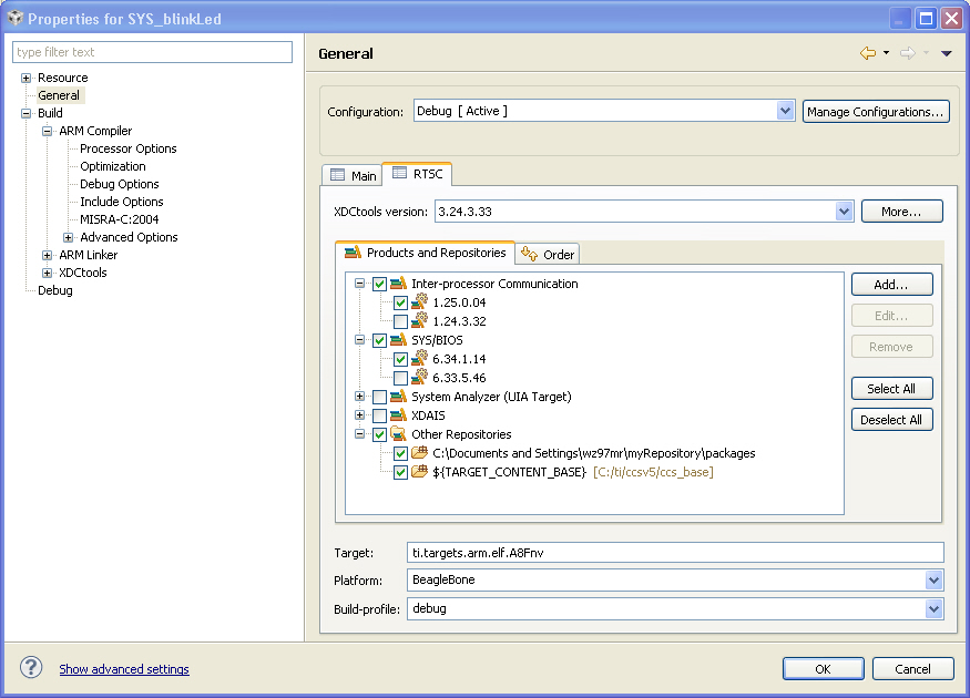

Hello, can anybody tell me what this warning relates to and what I need to do to get rid of it ?
Description :
current target 'ti.targets.arm.elf.A8Fnv' [1,0,4.9,5] is not compatible with targets used to build the following packages; package ti.sysbios.family.arm [in C:/ti/bios_6_34_01_14/packages/ti/sysbios/family/arm/] was built using 'ti.targets.arm.elf.A8Fnv' [1,0,5.0,1]
