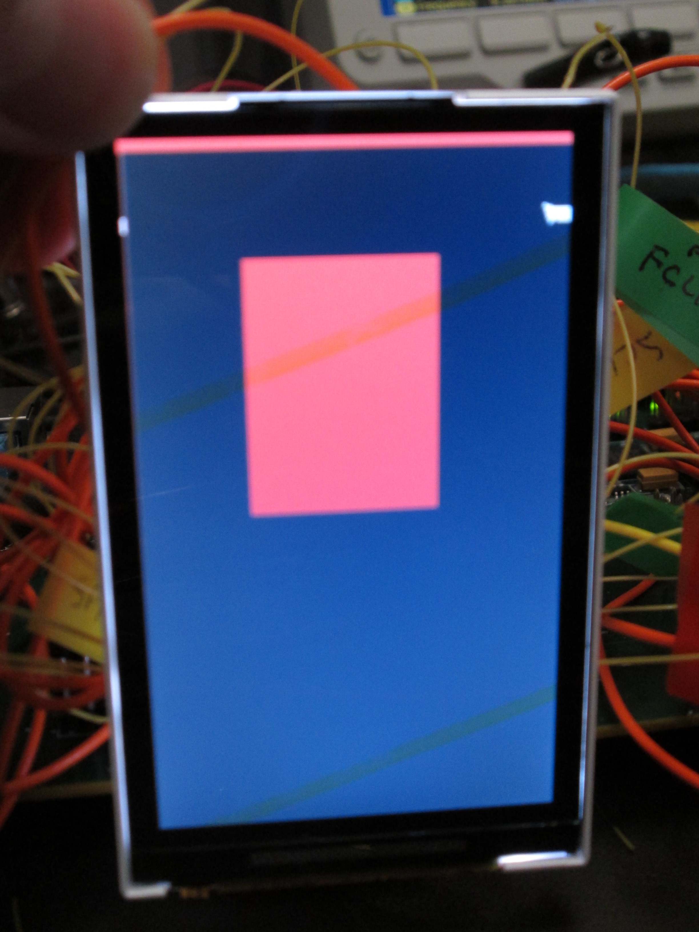

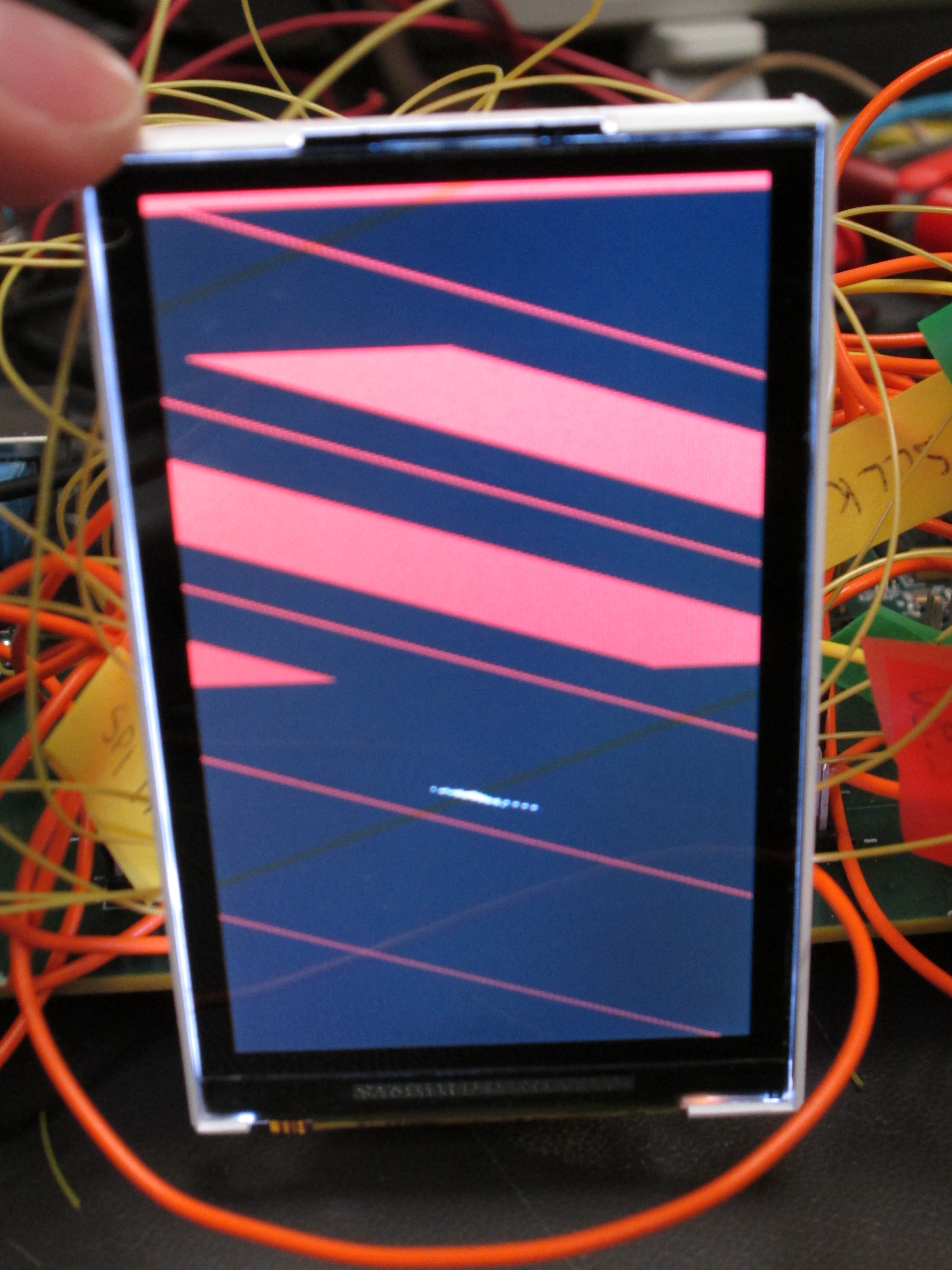

I have a GUMSTIX Overo Fire (GUM3503F) with the TI DM3730 MPU driving a Kyocera T-55149 240x400 LCD.  For some reason when the linux panel configuration (panel-generic-dpi.c) is set up with .x_res =240, .y_res=400, .pixel_clock=9200, .hfp=1, .hsw=1, .hbp=1, .vfp=2, .vsw=1, .vbp=4, an extra 4 pixels of data is fed to the LCD.  I check with an oscilloscope and the image gets cummulatively skewed by 4 pixels on every line.  This means that although I set up the TI processor for 240x400, actually 244x400 is output.  Even if i configure the panel to be 232x400, I can see that 4 extra pixel clocks are added to the output.  Why is this happening?

    Driver is configured 240x400
    Image:

    The pixel clock is 9.29 MHz.  Oscilloscope shows the horizontal sync frequency to be 38.23 kHz.  This seems to indicate that 9.39 MHz/38.23 kHz = 243 pixels of data drives display.  So data is cummulatively shifted by 3 on every line.

    Driver is configured 232x400
    Image:
    Image with arrow cursor to the right:
    Oscilloscope Capture:
    The pixel clock is 9.29 MHz.  Oscilloscope shows the horizontal sync frequency to be 38.71 kHz.  This seems to indicate that 9.39 MHz/38.71 kHz = 240 pixels of data drives display.  Picture looks perfect except the repeat data on the right side as show when the arrow cursor is moved to the right edge.  This is probably due to the front porch.  However, 3 pixels of data is still being added to each line 240 (Kyocera LCD width) - 232 pixels of data - 5 front porch clocks = 3 pixels per line. I would like to understand where the 3 extra pixels is coming from.

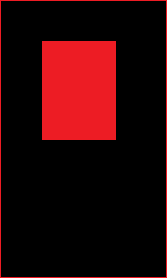

  • Forgot to post the raw test image
    Test Image

  • I figured it out.  On page 1785 of the AM/DM37x Multimedia Device Technical Reference Manual, it looks like you cannot set the Hsw, Hfp, or Hbp to be -1.  This is where my problem is because the Kyocera display requires 0 horizontal front porch, 0 horizontal back porch, and 0 pixel clock during the horizontal sync.  This means that I cannot use the TI processor for the Kyocera display.  Kyocera does not allow me to change the horizontal timing parameters.
  • Victor,
    DM3730 supports your display. But you've to use it in RFBI mode. In this the Kyocera display has a frame buffer inside. You've to use RFBI mode of DISPC so that it will consider the panel as a remote frame buffer, and keeps writing to it. In RFBI mode you don't need HSYNC, VSYNC signals.
