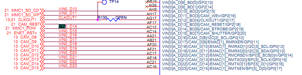

      I use the Camera Interface(I/F) to receive video data, like below:
      Can the interface(by 16bit data/clk/vsync/hsync) accept the embeded or discrete sync BT.1120 data?
      If yes, could give me any direction to do it.  Thanks.

  • Xue,
    The HW supports both embedded and discrete sync modes for BT.1120 capture.
    1. Is this DM385 or DM8127?
    2. Are you using any software release from TI for this work, if so please let me know the details? The exact interface spec is also published in ISS TRM which is currently available on request only. You need to work with the local TI support to get this document.

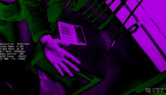

  • Dear Wang,
    Fllow your advice, we reconfigure the IPIPE.SRC_FMT ISIF and our system can accpet the 16bit YUV video data.
    thanks for your help very much.
    But there have a little matter.
    Now the U and V is input video is reversal. We try to switch the "outStreamInfo[streamId].dataFormat" with SYSTEM_DF_YUV422I_VYUY and SYSTEM_DF_YUV422I_UYVY. But it is useless.
    The worst way is swap the U/V on the DupLink, but it's waste for VPSS CPU capability.
    Could you know how to swap U/V in ISS module ?
    Xue
  • Make sure you sync polarity is right. You can also move SPH by a couple of pixels to see if UV swapping is really your issue.
    I don't see a register to swap u/v in iSS module. In the worst case, you have to modify the ISS driver to support u/v swap.
  • Dear Wang,
            Thanks for your reply.
            We swap UV on the video source device and then the image in 8127 is correct. So I belive the problem is on the UV swapping.
