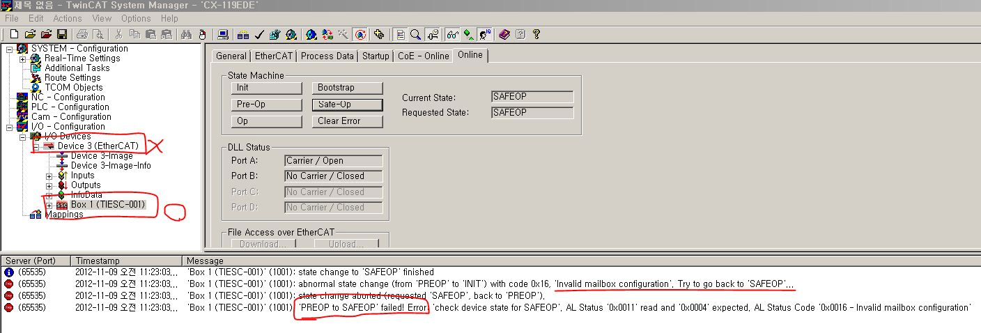

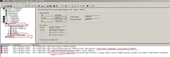

I'm testing AM3359 ICE with full feature ethercat  appl. But there is weird problem..
when I send Safe-OP command from Pre-OP or Init (In Box 1 Online Menu), 'Invalid mailbox configuration' error was appeared and disappear-
-> and slave states is ....  Pre OP -> Init -> Pre OP -> Safe OP
[ error was that SM1 Enable bit of ' SyncManager1 activate reg (0x80e)' is disabled..]  What makes this bit disable???

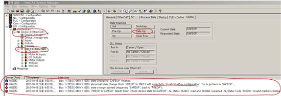

BUT !!  when I send Safe-OP command from Pre-OP or Init (In Device 3 Online Menu), State Machine was changed to Safe OP without error
What is difference between two command???
below is my twinCAT Capture..

    you should change EtherCAT state Machine in EtherCAT slave Box Not in Device (Master) Menu...  (see picture)

    This issue is seen when state transition (PREOP to SAFEOP) is performed at slave online tab and LRW support for process data is enabled. We have identified the root cause and fixed this issue in the latest firmware which will be part of 1.0.0.6 release (Mid December time frame). With 1.0.0.5 release, work around is to disabled LRW support for process data (Slave selection > EtherCAT > Advanced settings > Behavior > Check Use LRD/LWR instead of LRW ).
