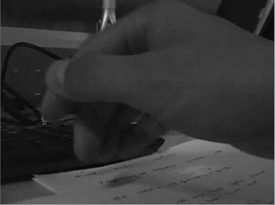

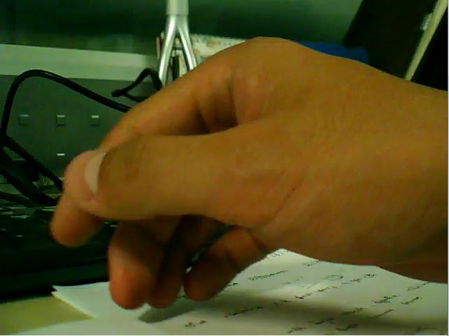

  • Hi Vladimir,
     I decode the output file back to yuv format and find that the Y component is normal as well as the U and V components are abnormal. The pictures are below. The fisrt one is the original yuv picture. The second one is the yuv picture decoded from the abnormal encoder output file. The third one is the Y component of the second one. It seems that the size of the U and V components is 1/4 of Y. I try to change the params of the decode but still make no progress.
      Bing
  • Hi Bing,
    Encoder takes 420 SP input only. Decoder o/p in the decode example is not exactly what decoder produces. It is modified to remove padding, as well format is changed before writing into file so that it can be played easily in any player. If you remove those padding only and retain the color format, you can give that to encoder. Infact, you can write an IL client having only decoder and encoder, that would work fine. ( Only thing to take care is decoder o/p pitch is with padding and 128 byte alignemnet, so same pitch should be set in encoder)
    Vimal
  • Hi Vimal,
        Thanks for your reply! I found the issue and managed to encode successfully. The OMX manual said that the decoder output format and encoder input format were both 420SemiPlanar. But actually the output in the decode example is YV12 not NV12. So, the encoder input mismatched. I modified the decode example and made the output file to the right format. Then, the encoder worked fine and produced right h264 output.
