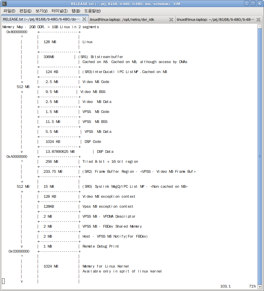

How can i set 2G DDR3
How can i set 2G DDR3 ?
i checked config_2G.bld(src_bios6/cfg/ti816x/ ) file and read ti install guide.
but m3 is not start.
Pls will you recommand me a  config_2G.bld's bootargs setting? (may i use vmalloc?)
i modified like this.
1. Rules.make DDR_MEM := DDR_MEM_2048M
2. setenv bootargs 'mem=468M
console=ttyO2,115200n8 root=/dev/nfs rw rootfstype=jffs2
nfsroot=192.168.1.200:/home/work/netra/dvr/rfs
ip=${ipaddr}:${serverip}:${gatewayip}:${netmask}::eth0:off vram=20M
notifyk.vpssm3_sva=0xBEE00000'
my env is DVRRDK3.0.0.0

  • Can you share the config_2G.bld you are using.
    Also have you done memory test on the 2G from uboot to confirm memory is accessible
  • Hi Narayanan.
     I attached bld file .
    8080.config_2G.pdf
  • This config.bld is incompatible with your your kernel bootargs.
    Config.bld allocates only 128M for linux .
    You will have to modify your bootargs as
    mem=128M mem=340M@0xC0000000
    Are you going for 2G memory map to increase linux size or do you require more frame buffer memory
  • HI Narayanan.
    it works good.Thank you.
    after 2G memory map, UI response time is very fast.
    when i showing the menu, menu display takes 2~3 second previously, but current it takes 0.5 seconds.
    and switching live , playback is more fast.
    I have a another question,
    340M is used In the second segment .
    is it right that  120M+ 340M memory is used for linux userspace and extra 460M memory is used  for linux kernel space ?
    current my env.
    cat /proc/meminfo
    MemTotal: 448896 kB
    VmallocTotal: 565248 kB
  • The total memory available to linux = 128M + 340 M = 468M. This is for both user + kernel space. Of 468M , 20 M is allocated for vram (for fbdev) so 448M is net available. This is the total lowmem available with usual 3:1 split between user:kernel space.
  • Thanks for your answer.
    as you mentioned above, now available memory is 448M ?
    and extra 460M memory is not available?
    when i change "mem=128M mem=440M@0xC0000000" , then there is available memory 548M ? is is right?
    Thank You.
    Regards.
  • Yes that is correct.
