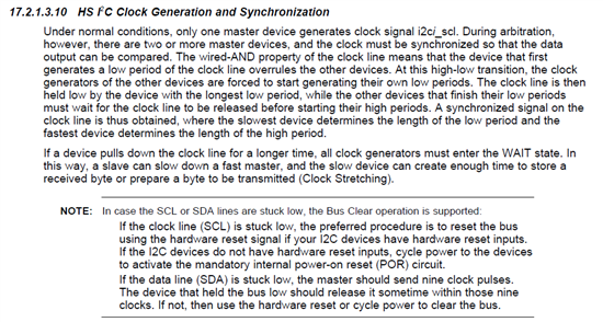

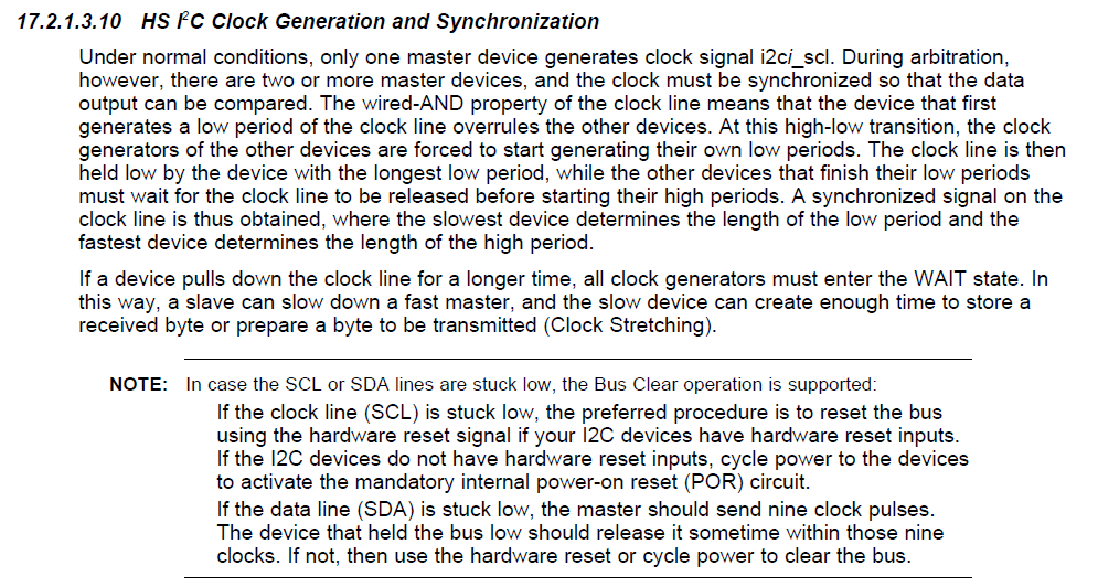

Is I2C "clock stretching" supported on DM37xx?
Other Parts Discussed in Thread: DM3730
Hey,
I'm have a I2C device that holds the I2C SCL (clock) low to indicate the wait period back to the master (DM3730).  I know this as "Clock Stretching".  I saw the below post where it is inherently supported for DM814X but I need to know if it is on the DM3730.  I couldn't seem to find it mentioned in the TRM.
http://e2e.ti.com/support/dsp/davinci_digital_media_processors/f/99/t/113021.aspx
JD
