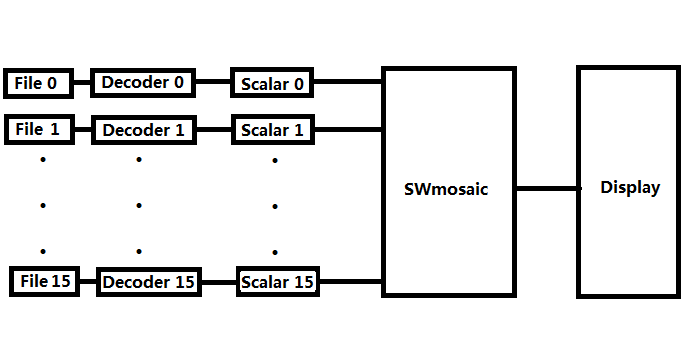

  • Hi Pavel,
        As the picture showed,I just wanted to decode 16 D1 files,did not need capture component.
        Could EZSDK support?Or could I only use DVR RDK?

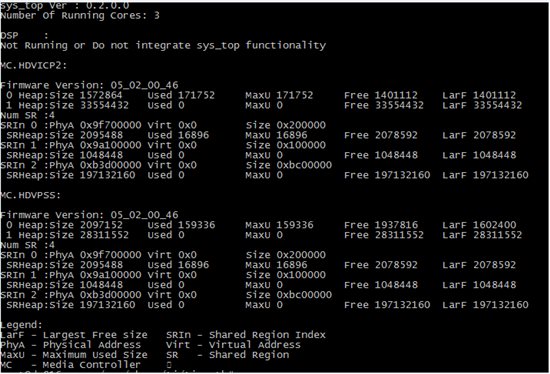

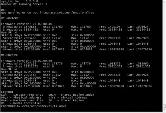

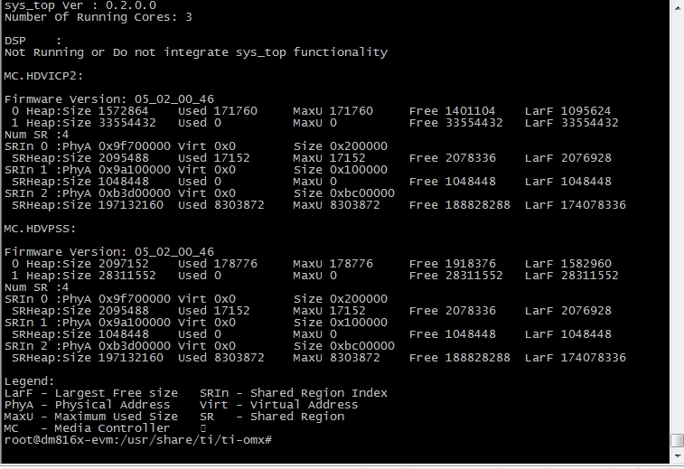

        By the way,I followed the doc <How to increase Heap Memory available to VPSS and VICP M3 cores v2>:
            1、changed the base address and size of memory sections,
             2、build mm_dm81xxbm.bin and copied it to the Target
            3、edited /etc/init.d/load-hd-firmware.sh on the Target
            4、changed A8's memory map and build the application.
        The followed pic shows the sys_top.The first is before change,and the second is after changed.I think it does not work.Is there something wrong I did ?
        Thanks!
        Best Regards!
    Strachey
    Before proceeding, please make sure you can parse 16 D1 streams on A8. If this is ONLY application on DM8168, you want to use, EZSDK could support this, however current version has limitation of 8 channels only. As suggested, you could explore RDK as it suits more for multichannel apps.
    Vimal
