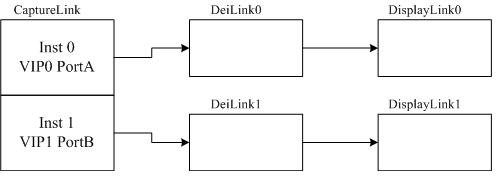

I`ve encountered some problem with DeiLink,
the chain work fine without two DeiLinks, but doesn`t work properly when I insert two DeiLinks into the chain as described above,
I want to know how can I set DeiLink parameters and how can I send command to control them properly,
these are my codes below:

  • In your code no output queue is enabled. Please check if below params work:

  • Thanks for your timely response Badri!
    I`m sorry to say it still doesn`n work properly;
    this is my latest code in accordance with your suggestion, I`m sure that there is out queue enabling in my codes...

    I want to know,
    (1) apart from parameter setting , if I should send some commands to control DeiLinks to work properly,
    (2) how should I set inputFrameRate,outputFrameRate,inputDeiFrameRate,outputDeiFrameRate parameters,
    (3) how can I enable or disable channel(s) in each queue,
    I will appreciate your timely response!!!
  • If you have access to DVR RDK source code, you can refer /dvr_rdk/mcfw/src_linux/mcfw_api/usecases/multich_vcap_vdis.c which does something similar to what you want you can remove links that you dont need like nsf,swms.If you dont have the code I can share the file.
  • Okay! I have DVR RDK 3.0, I can refer it .
    Thanks for your suggestion!
