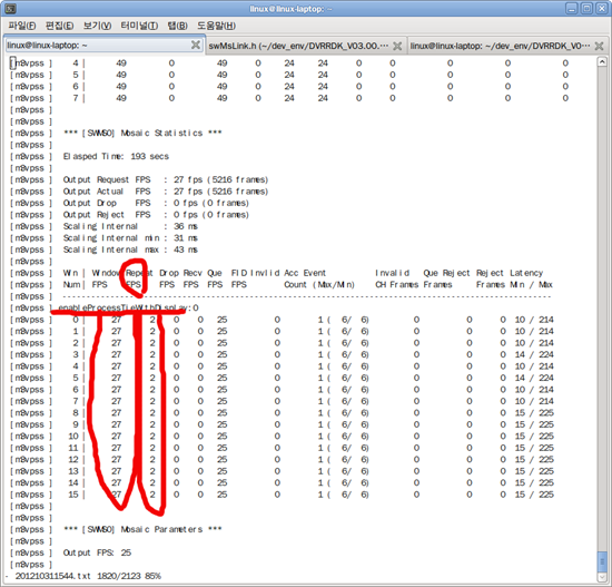

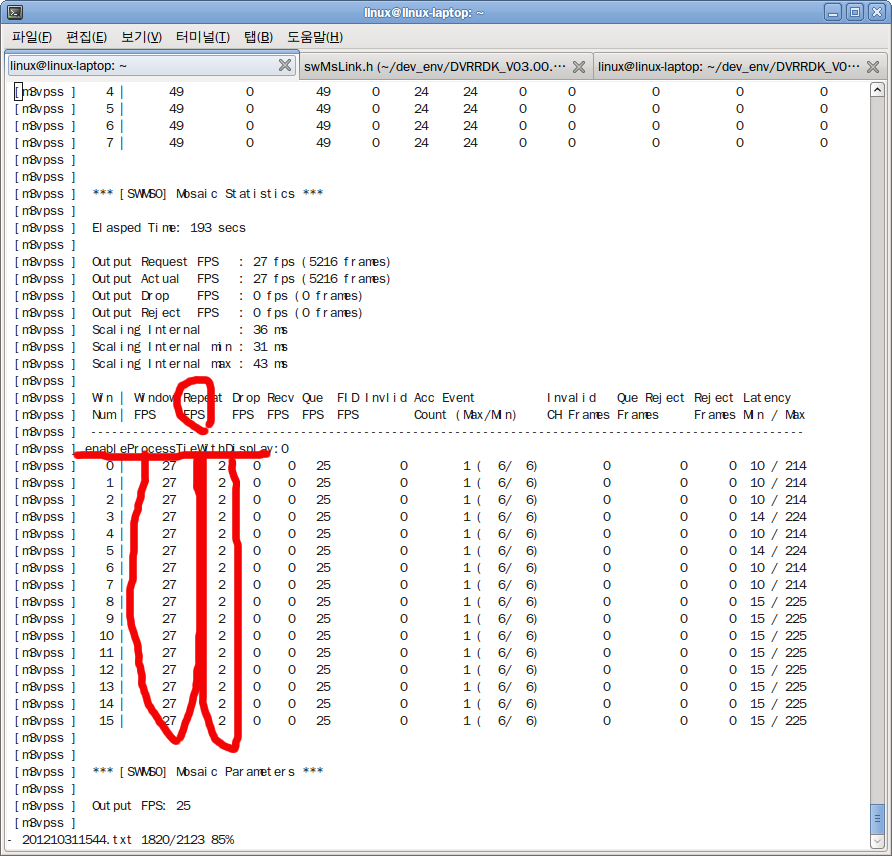

when i set PAL mode, output fps setting is some strange.
i think that window FPS must be 25fps, and repeat FPS must be 0 fps. why FPS setting is NTSC based setting?
where can i check ? if you need full log , i will attach it.

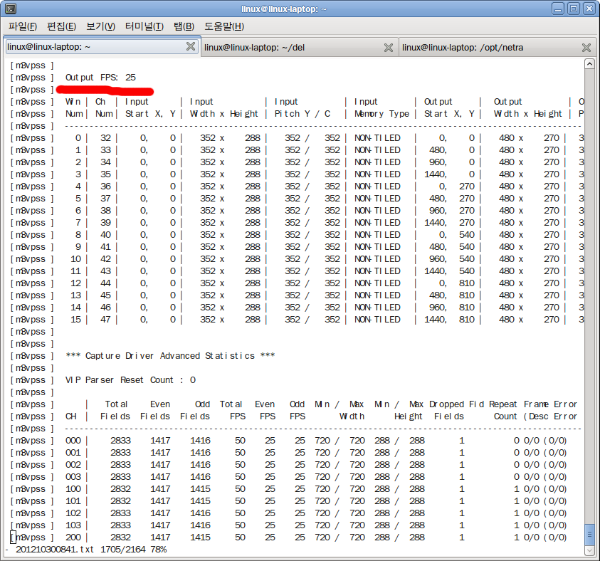

    at the my full log,
    first my swms output fps is setted 25 fps.
    [m3vpss] ***  [SWMS0] Mosaic Parameters ***
    [m3vpss] Output FPS: 25
    second my display is configured for 1080P60.
    and third "swMsLink.h"(DVRRDK 3.0.0.0)
    static inline void SwMsLink_CreateParams_init(...)
    pPrm->enableOutDup = FALSE;
    pPrm->enableProcessTieWithDisplay = FALSE;
    pPrm->initOutRes = SYSTME_STD_INVALID;
    full log is
    6837.201210291815.pdf
  • as you see , The SwMs output fps is 25.
    i setted Output FPS 25. is there any check point?

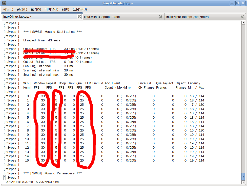

  • You have to set output fps in SwMsLink_LayoutPrm.outputFPS in your using link APIs. From your log I see the SwMs window FPS still set to 30.
    If you are using Mcfw API,  set VDIS_MOSAIC_S.outputFPS before invoking Vdis_setMosaicParams();
    Additionally I see encode link dropping frames. Looks like the application is not freeing buffers from ipcBitsInLink in time.

  • Looks like you have set
    swMsPrm->enableProcessTieWithDisplay = TRUE in your usecase file.
    Pls check this parameter setting before SwMsLink is created.
    Add Vps_prints in SwMsLink_drv.c to confirm this flag is really disabled.
  • i checked usecase.
     enableProcessTieWithDisplay setted TRUE in my use case(  VSYS_USECASE_MULTICHN_PROGRESSIVE_VCAP_VDIS_VENC_VDEC)
    and i checked mcfw_demo and udworks sample , all of that windows FPS is setted 30 FPS in the PAL signal.
    The  usecase  VSYS_USECASE_MULTICHN_PROGRESSIVE_VCAP_VDIS_VENC_VDEC   alaways setted that enableProcessTieWithDisplay is TRUE.
    why i check window FPS is that i seeing  moving object interval is diffrent ( like stop and go) in the PAL signal.
    i think  repeated frame affect live display.
    do you think enableProcessTieWithDisplay is helpful?
    what do you think about that 1920x1080 50, 1280x720 50, 1280X1024 50, 1024X768 50 is helpful?

    when enableOuputDup and enableProcessTieWithDisplay setted FALSE,  vps_Printf result   window FPS value is 27 FPS (not 25 FPS) and 2FPS repeated .
    i think PAL customers use 1080P60 or XGA60 in the PAL zone. (XGA 50 and SXGA 50 does not exist).
    i want to 25FPS setting and smooth display(not anymore stop and go) without repeated FPS and externel interface that change value of "swMsPrm[i].enableProcessTieWithDisplay".
    any advice will be appreciated.
    Thanks. CHO.

    1272 // kisung cho
    1273 if(deiId == DEI_LINK_OUT_QUE_DEI_SC){
    1274 printf("DEI_LINK_CMD_SET_FRAME_RATE vcChnId:%d, vStrmId:%d, deiId:%d input:%d, output:%d\n", vcChnId, vStrmId, deiId, params.inputFrameRate, params.outputFrameRate);
    1275 }
    1276 // kisung cho end
    1277 status = System_linkControl(gVcapModuleContext.deiId[deiId], DEI_LINK_CMD_SET_FRAME_RATE,
    1278 &params, sizeof(params), TRUE);
    1279 #if defined(TI_814X_BUILD) || defined(TI_8107_BUILD)
    </code>
    result log ( we have 8 channels)
    DEI_LINK_CMD_SET_FRAME_RATE vcChnId:0, vStrmId:0, deiId:0 input:5000, output:3000
    DEI_LINK_CMD_SET_FRAME_RATE vcChnId:1, vStrmId:0, deiId:0 input:5000, output:3000
    DEI_LINK_CMD_SET_FRAME_RATE vcChnId:2, vStrmId:0, deiId:0 input:5000, output:3000
    DEI_LINK_CMD_SET_FRAME_RATE vcChnId:3, vStrmId:0, deiId:0 input:5000, output:3000
    DEI_LINK_CMD_SET_FRAME_RATE vcChnId:4, vStrmId:0, deiId:0 input:5000, output:3000
    DEI_LINK_CMD_SET_FRAME_RATE vcChnId:5, vStrmId:0, deiId:0 input:5000, output:3000
    DEI_LINK_CMD_SET_FRAME_RATE vcChnId:6, vStrmId:0, deiId:0 input:5000, output:3000
    DEI_LINK_CMD_SET_FRAME_RATE vcChnId:7, vStrmId:0, deiId:0 input:5000, output:3000
    attached file is full log
    6232.201211011735.pdf
    my env screen
