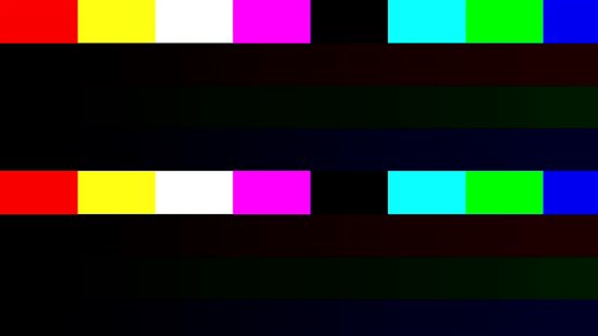

I've written a small test to try out pattern generator and ISP. After starting the modules the process halts in the middle of the 11th row (see attahced picture). What happened?

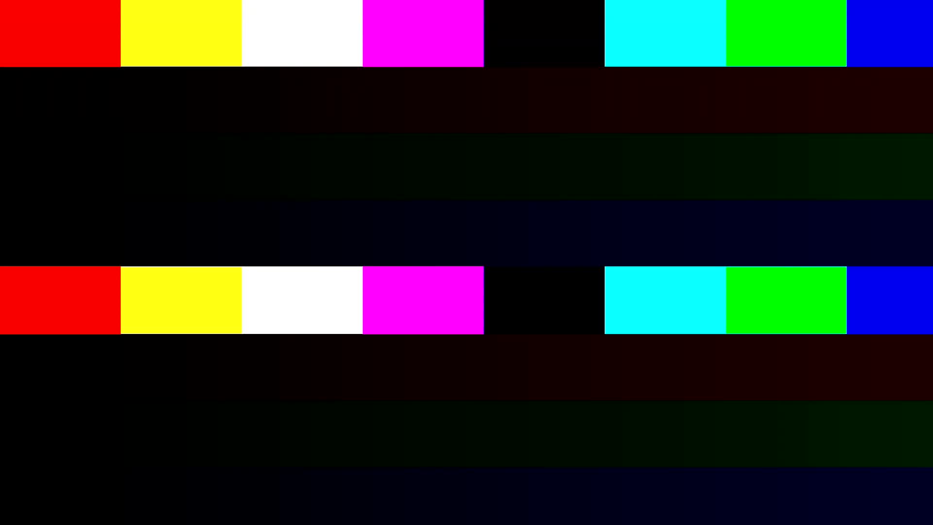

    Additional information: I've changed the parameters as the followings:
    • PG width: 4000 => 2000; PG height: 2200 => 1100
    • IPIPE VSZ 1080, HSZ 1920
    • RSZ HSZ, VSZ as same as IPIPE
    • RZA V_DIF and H_DIF 128 => 256 (0.5 => 1.0)
    Now it's working, as the attached picture shows. I think the problem should be a IPIPE/IPIPEIF//ISIF parameter issue, but I can't imagine what.
