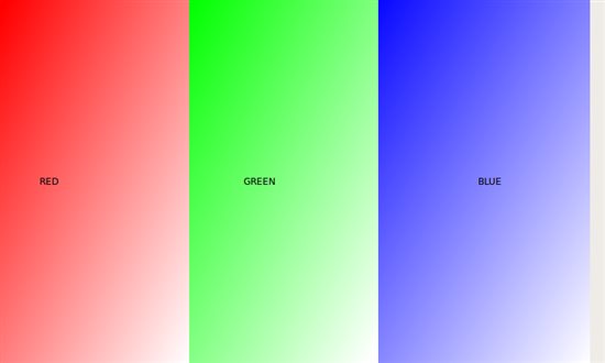

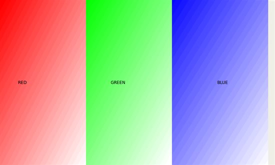

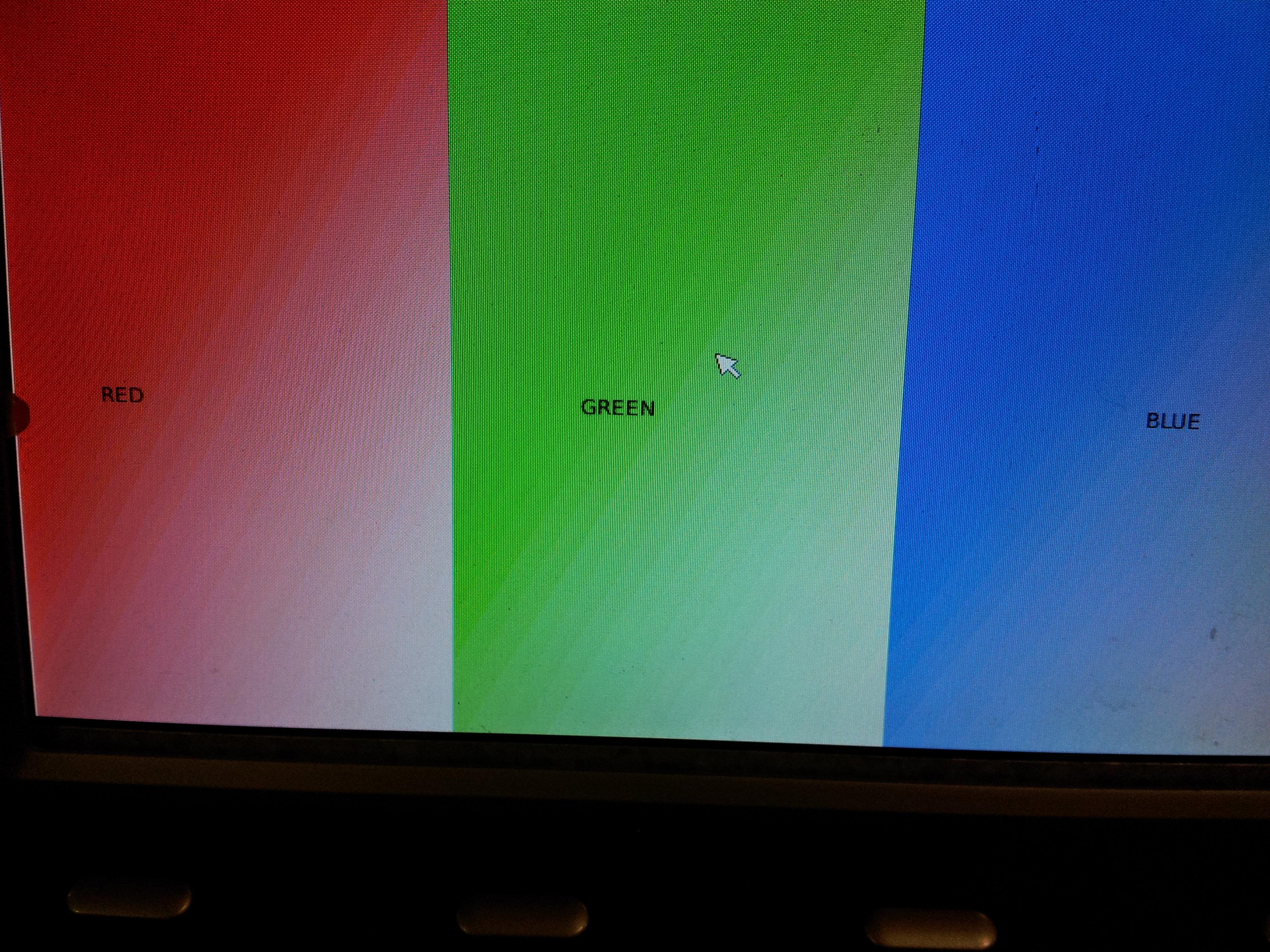

Loss in Image Quality when 24 or 16 bit image is displayed on LCD using DM 368
Dear TI
We are using DM 368 processor and a 24 bit PRGB interfaced LCD  (from Truly ) having  resolution of 800 * 480 ( size is 7 ''). We have an application which shows gradient of colors in Red, Green, Blue. This application was compiled for the PC and DM368. When we execute on PC Gradient looks very smooth there is no blocking effect (see PC_Image.BMP) but when we execute application for the DM368 we are getting blocking effect (see DM368_Image.BMP). It looks like it is showing application output in 16 bit colors.
We recompiled QT with 24 bit configuration only even then we are getting same result.
How to achieve 24 bit images of QT on LCD output of DM368.
Image Quality seen on PC
Image Quality When displayed on DM 368

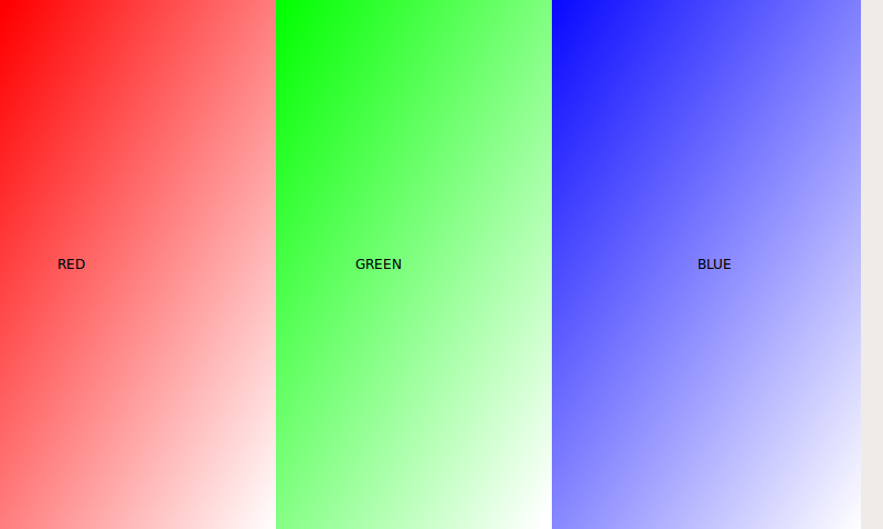

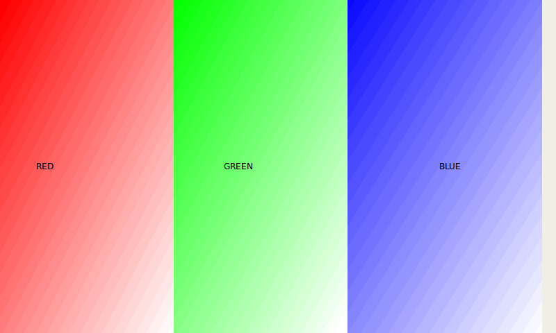

                  There is a little improvement in the picture but still it is not producing the same image as displayed on the PC. Pls find the reference picture. could tell me the problem why there is little improvement and why it is not producing the exact picture as displayed on PC ? Is there any problem in the schematic or interfacing to LCD ? As per my understanding, the loss in image quality may be due to the OSD module which merges and converts to yCbCr  (vid0,vid1, osd0,osd1)  first then to rgb 888 ? Here color conversion (from rgb 888/565 --> to yCbCr ----> rgb 888) is done and due to which there is loss in quality of image. A'm i right ?
    regards
    pradeep
  • Your understanding is correct. Finally everything is 16-bit. I'm still not really convinced whether this is the best possible with 16-bit or not.
    Can we try to generate similar pattern with RGB565 and compare the output with this?
    Also can you generate another Red pattern and with just four colors 0xFC0000 0xFD0000 0xFE0000 0xFF0000 where only four minor changes are there in the LSB. You can create four vertical bars with these colors and then see whether you are able to differentiate between the four red color bars? Similarly you can validate other bits of all colors.

             When we tried to check if r0-r7, b0-b7, g0-g7 signals are coming from DM-368, we observed that r0,b0,g0 signals are low which means that the o/p from DM 368 is rgb 777 instead of rgb 888. I checked the pin mux 4 register setting, The Gio27,gio29,gio32 is enabled as per the pin mux 4 register settings. I do not why the o/p is not coming from the ro,b0,g0 pins ? do you have any idea on this ?
    pradeep
  • Are you sure that GIO27 28 and 32 are enabled or B0, B1, R0 is enabled in PINMUX4?
    Also can you check one simple thing. In the pattern that you are trying, can you set the R0, B0 and G0 bits to zero and try to view it in PC and see whether that matches with our display?
  • Renjith,
     Yes the r0,b0,g0 bits are enabled. the result is the when i disabled the gio 27,28 and 32 bits. The picture displayed on LCD matches with what is seen on pc when these bits are disabled. As i earlier said, the o/p of ro go bo pins are in LOW when seen in oscilloscope. i do not why there is no data on lower bit even though the gio pins of the pin mux 4 register are enabled
    For confirmation when i read the pinx mux 4 register its value is 55557CFF . As per the dm368 document, pin mux 4 register, bit 0-1 is Bo (gio 27) , bit 4-5 is g0 (gio 28), bit 10-11 is R0 (gio32)
    pradeep

                  The LCD panel is expecting  rgb 888 but currently the o/p from DM 368 is only rgb 777. I think the o/p from DM 368 should be rgb 888 and not rgn 777. There seems to be a problem from DM 368 side.
    pradeep
  • Renjith
                     In the schematics ro,bo,go was not connected that is why we were unable to see the signals . After connecting them, we are able to see signals on r0,b0,g0 pins. But still the image quality did not improve. It was same as before i,,e there is no impact on correcting the lower bits. This means that the o/p from DM 368 should be a problem ? Does it mean that the color conversion from 16 bit yuv to 24 bit rgb 888 is a problem in DM 368 ?.  Do you have any idea on the driver part which takes care of configuring the yuv to rgb conversion ? Should we suspect OSD module which merges the frames ?
    pradeep
  • Pradeep,
    We can't expect RGB888 from 16-bit YUV without data loss. But can we convert the same 24-bit image in PC to a 16-bit image and see whether it is same as the boards one?
    Then, can you write a small PC tool to just create 16 different images from the image file that you are using where you set bit 0, 1, 2, ..7 with 0 or 1. Compare the 16 different files and find out which one matches best to your LCD output.
    Assume that if there is any hardware line getting shorted or something wrong with the connections, we can figure out which bit is causing the trouble.
