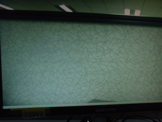

In the example of capture-dei-encode, I add the NF component (capture-nf-dei-display).
If there is no nf, the display is normal. If there is nf, the display is no normal and there is a gray rectangle in the bottom of screen.
Who also appeared in this case?  I am looking forward for your help.
Thanks.
  • There is a gray rectangle in the bottom of screen.
    The configuration  of NF is as following:

    why the display is no normal ? someone can help me?
  • This thread is discussed here:
    http://e2e.ti.com/support/dsp/davinci_digital_media_processors/f/717/p/222531/791086.aspx
