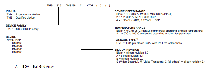

Hi experts,
I cannot find TMS320DM8168CCYGH in the device nomenclature.

TMS320DM8168CCYG (speed grade blank)
TMS320DM8168CCYGH (speed grade blank + HDCP)
Have you got the part number with H at end?
Hi ,
Thank you.
Does HDCP mean "High -bandwidth Digital Content Protection"?
We are looking for high speed DM8168, so we want to know the difference between CCYG, CCYGA2, CCYG4 and CCYGH, so CCYG4 should be the fastest one, right?
