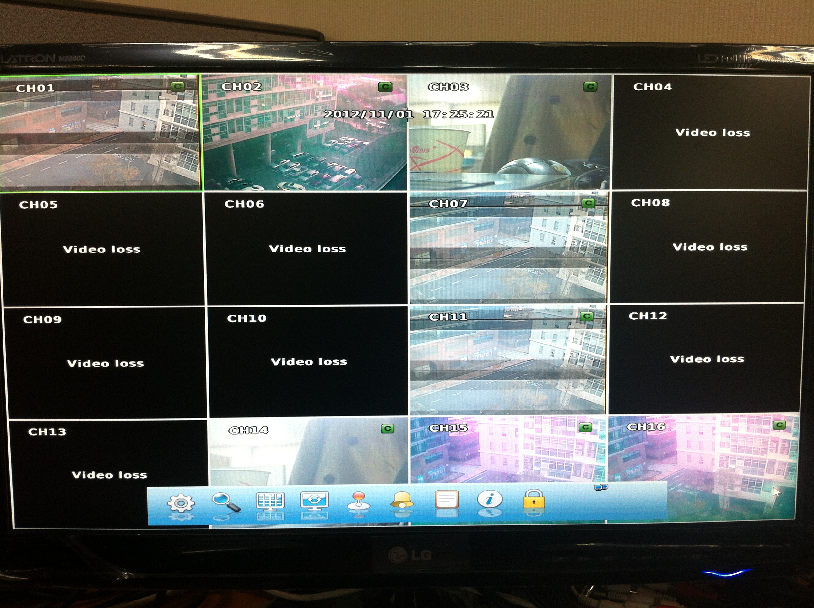

  • HI
    it's my log's of 2x2 windows.
    7357.201211011735.txt
    i will check another things.
  • The logs look fine . Looks like you still have an issue with your camera connected to channel 10 and channel 12 where a lot of FID repeats are seen. Pls view channel 0 -7 on SwMs with 2 x 2 layout and check if the smoothness has improved.

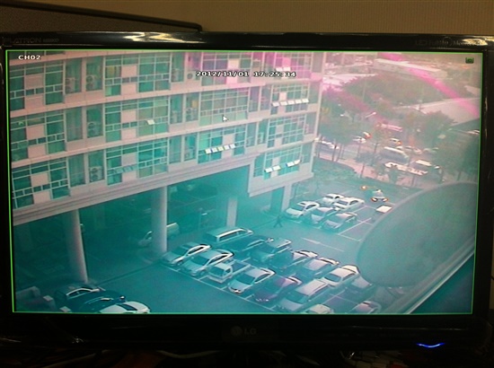

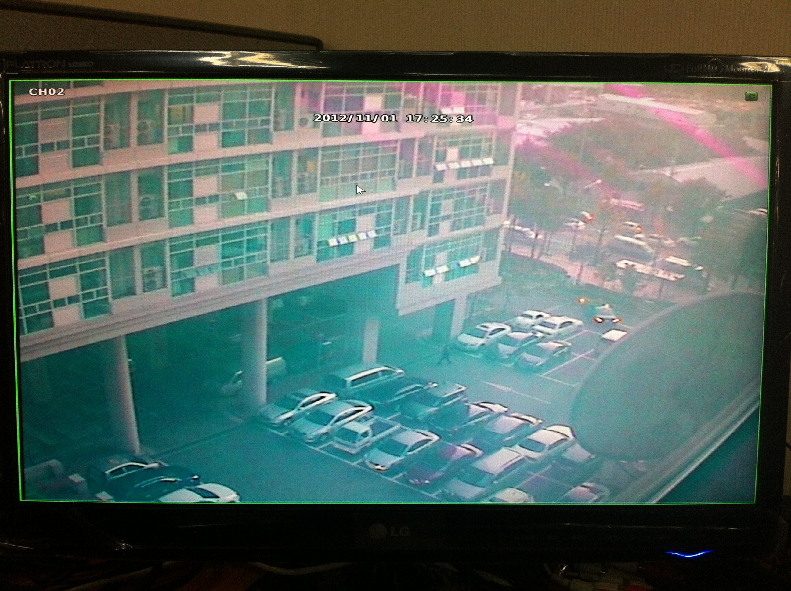

  • Hi .
    i removed FID repeats camera, it's ok now.
    i attached my log, now log is ok. but it's not improved video smoothness.
    4812.201211021021.txt
    it's stop and go video , you will see vehicle is not smooth. it's some diffrent real see then seee the video file .
    Pls can you give me a detailed info  where is the modify?
    i don't know the right place of changing soure point of VIP_SC_SECONDARY and etc.
    Regards. CHO
  • Mr.Cho,
     The stats look clean as you said. If you are not seeing improvement in 2x2 layout after making this change then making the changes for VIP_SC_SECONDARY will not help since it is also does the same.
      The issue is not clear from the video you sent. Is the issue that fields are moving back and forth or is it motion is not smooth ? When playing back the video very slowly in vlc player we see the motion is uniform but fields are moving back and forth.
  • Hi Narayanan.
    The issue is "stop and go". you said "back and forth" , but i feel this issue "back and forth" and "stop and go" both.
    I don't know this sceen is "stop" or "back"  surely, i can't  ensure "stop and go" or "back and go", it's sceen almost the same.
    i issued it's not smooth live display.
     This "back and go" (or stop and go)  phenomeno  is not appeared in the NTSC mode. only PAL signal appeared thus i checked repeated FPS and windows 30 FPS.
    How does the your pal camera load view seen?
