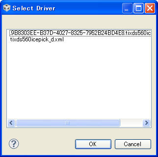

blackhawk XDS560V2 usb Mezzanine Emulator has no library!
I have a TMSC6657EVM Board with non XDS560v2 usb Mezzanine Emulator.
I put a XDS560v2 usb Mezzanine emulator of a TMSC6678EVM Board on the TMSC6657EVM.
But when I select the blackhawk XDS560V2 usb Mezzanine Emulator in the target configuration, select driver window jumps out.
I don't know the driver what it want.
How should I proceed to solve this?

  • Jing Bai,
    We do not support removing the XDS560V2 mezzanine from the EVM and reusing it on another board - not even another of our KeyStone EVMs.  The mezzanine emulator is part of the EVM and it is made to only work with the EVM.  This violates your warranty as well.  If you need a C6657 EVM with integrated emulation, you need to purchase the EVM version that contains the emulator.

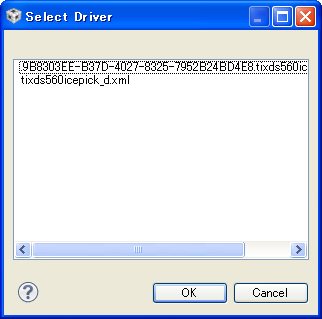

  • RandyP,
    Thank you for your answer. I have been updated to the latest version of CCSv5.2.1 and that my emulation drivers also have been updated to the latest version of Blackhawk Emulation Drivers v5.2.0.205.
    Here is a new issue with my ccsv5.2.
    When I create a new target configuration and select the Blackhawk XDS560v2-USB Mezzanine Emulator, the following windows jumps out also.
    Whichever I selected doesn't work.
