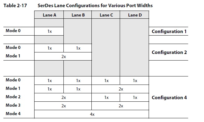

when I learn the SRIO of 6678. I am confused about the PLM_SP(n)_PATH_CTL register which is on page 227 of SPRUGW1.what does mode0~mode4 in PATH_MODE mean? and what does 4-4 lanes in PATH_CONFIG mean? thanks

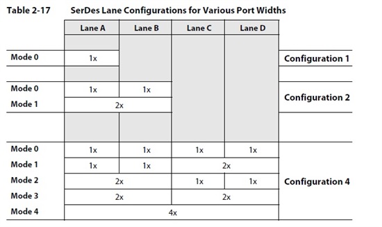

Mode 0 to Mode 4 refers to the lane setup per port. The PATH_CONFIG refers to how many lanes are available for use. For example, a value of 100 (Configuration 4) means that there are 4 lanes available. This would allow for a maximum of 4 ports (one lane each).
Table 2-17 on page 51 of SPRUGW1a has a pretty good explanation:
