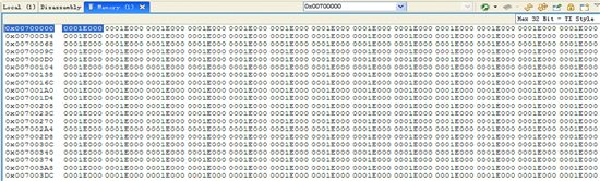

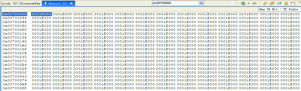

I made a board based on OMAP-L138.After connecting to its DSP through XDS560 JTAG EMULATOR ,it turned out there was no DSP RBL in DSP L2 ROM ,here’s the memory information:
Could anyone tell me why?
PS:1、My chip No. is $7-07AHEPW
2、I didn’t supply power to its USB periopheral. And the OMAPL1x_debug.gel printout is as follows:

Among above information, what does ”ROM Status Code: 0x00000086  Description: Not supported for non-secure device” mean? Why isn’t it ”No Error”?

    Hi Cicy
    You have silicn rev 1.1 and if you have not applied power to USB_CVDD (M12) or SATA power pins, you are impacted by the silicon errata 4.1.3 that applies to all silicon revision upto Rev 2.0.
    This will cause the behavior you see.
    Please review the OMAPL138 errata, 4.1.3, and either move to Rev 2.1 silicon or see if it is possible for you to modify your Rev 1.1 board to apply power to USB and SATA power pins.
    Mukul
  • Hello Mukul,
    Thanks a million for your reply !This trouble has been disturbed me for a long time.Thank you for saving me...o(∩_∩)o...
    Cicy
