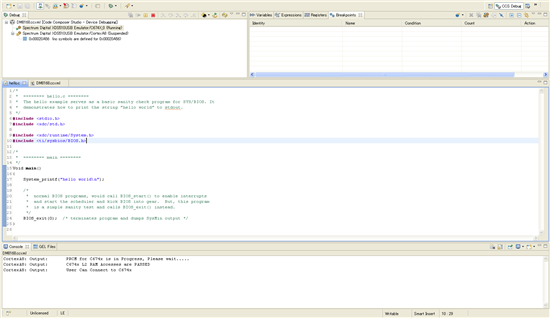

I have created a simple DSP program, "hello world" message is not output.
Someone please tell me.
-----Development Environment-----
Code Composer Studio v5.2.1.00018
JTAG: SpectrumDigital XDS510USB Emulator
Board: UDWORKS DM8168DVR RDK
Platform: SYS/BIOS

3.Select *.ccxml
[TargetConfigurations]
Selected DM8168.ccxml (XDS510USB+DM8168 based)
Launch selected Configration.
4.CortexA8 connect-target
5.Load GEL file
Load evm8168x.gel (spectrumdigital)
----- console ------
CortexA8: Output: PRCM for C674x is in Progress, Please wait.....
CortexA8: Output: C674x L2 RAM Accesses are PASSED
CortexA8: Output: User Can Connect to C674x
6.Menu options Scripts -> TI816X CPU BRINGUPS, and select c674x
7.C674X_0 connect-target
8.Run-Load Program
Load program hello.out
Suspended->Running changes
"Hello world" but does not appear in the console.
Why?

  • Hi Hideki,
    Please try the Dvr_netra.gel file that was shipped with the board from UDWORKS.    Let me know the results from using this gel file with your hello project.
    It's important that you use correct gel file.
    -Jon
  • Hi Jon,
    I tried dvr_netra.gel.
    I will report the results of running.
    6735.result.pdf
    In terms of results, "hello world" is output.
    I did with the additional
    -That it has made in the memory initialization scripts ( Scripts-NETRA External Memories-DDR3_796MHZ_doall )5633.dvr_netra.gel
    -That you have run main () in MoveToRun. "main()" function is not executed even if the Load Program.
