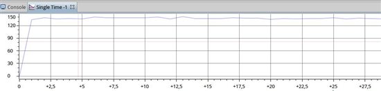

  • Hello
    I have now tried the example 2.7 from your book and everything works fine but i have one question. Which amplitude did you choose for audio in?
    In the datasheet from the AIC3106 codec is a value of typical 0.7 Vrms. For security reasons i have tried 0.035 Vrms and the wave does not look like a sinus.

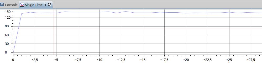

  • Hi Christian,
    You say that everything is working fine but then contradict this by saying that the wave (the data stored in inbuffer, I presume) does not look like a sinus.
    I have just reproduced the result shown on page 62 of the book and to get sample values in the range +/-9000 the input signal is 1V peak to peak.
    The 35mV rms you say you are using is quite small. However, I just tried the program with a smaller input amplitude and got the results attached .
    Channel 1 on the 'scope is the output (filtered using a first order CR filter to get rid of out-of-band noise, as per page 68 of the book) and channel 2 is the input.
    As you can see the samples processed by the program are in the range +/-500.
    Donald
  • Sorry for my misleading problem description. Now i get the same results as you, even with smaller amplitude. I added the following lines to your code:
    interrupt void interrupt4(void) {
    .. your code...
    if (buf_ptr == 511) {
         while(1);
    return;
    main() {
    When i press the Halt button the program stops at the while(1) loop in the interrupt routine. Then i can do the single time graph with inbuffer.
    Later i have to FFT (fast fourier transform) this signal, so maybe i do not need this code snippet, cause the data will be in inbuffer anyway.
  • Hi Christian,
    Glad to hear you've got the program working. You shouldn't need to add anything to the code in order to view the contents of inbuffer. If you halt the program that is listed in the book, inbuffer should contain the BUFSIZE most recent input samples read from the ADC.
    Donald
