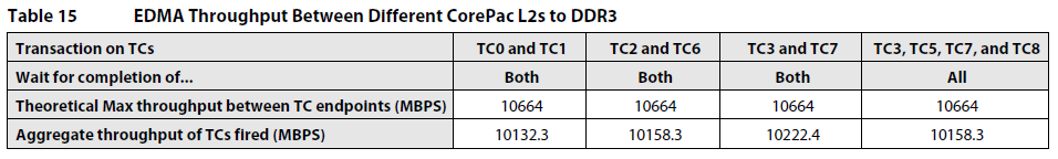

hello:
I saw the pdf << Throughput Performance Guide for C66x KeyStone Devices>>, 5 EDMA3 Complex Throughput:
1 .some tables show that  Aggregate throughput of TCs fired is  larger than Theoretical Max throughput between TC endpoints, it wonder me,for example
5.6 Scenario 6: EDMA Transfer From Different CorePac L2 to DDR3   table 15.
2 . it says TC0 and TC1 can work simultaneously, I want know how can I make TC0 and TC1 work  simultaneously,  if I want to make them work simultaneously, what
need I  set ?
Thanks!

    When I look at the section you mention, it does not show the measured numbers being larger than the theoretical numbers:
    I do not see the problem. Although these numbers are very idealistic, they are still reasonable. Are you looking at the latest release of this Application Note, SPRABK5A dated July 2012?
    need I  set ?
    You do not need to do anything. If both TC0 and TC1 are loaded with Transfer Requests, then they will be operating simultaneously. This is similar to how running a program on CorePac0 and running another program on CorePac1, both will be running simultaneously.
    For the EDMA3 modules, each DMA or QDMA channel will have a CCQueue number assigned to it and that CCQueue number corresponds to a Transfer Controller. If you start two channels that are assigned to different TCs (CCQueues), then those two TCs will be operating simultaneously.
