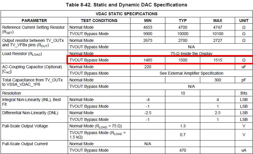

Hi all,
I want to use an external video dac amplifier instead of internal ones.
Datasheet referencing TRM but there is no any relevant information on TRM.
There is only a gain information (3.7V/V) on Figure 42. (pg. 272)
Could you please supply us related documentation or directly suggest appropriate video amplifier.
(I prefer dual channel amplifier with intertanal reconstruction filter.)
Best regards.
For additional Video DAC Design guidelines, see the High Definition Video Processing Subsystem chapter of the TMS320DM814x DaVinci Digital Media Processors Technical Reference Manual (Literature Number: SPRUGZ8).
