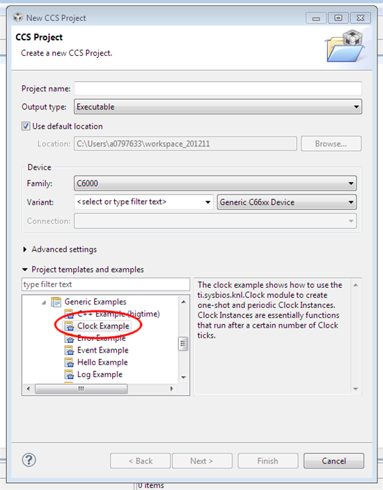

I have bought TMS320C6657 board. I installed CCS5.1.x. I am looking for some example project through which I can control GPIO and Timers. In the technical resource, I do not see any example project available. Any help will be appreciated.
  • Hi Shuja,
    Regarding Timers, if you don't need to access a hardware timer directly, Clock module of SYS/BIOS provides some timer and clock related functionality.  You will find an example code of BIOS Clock module as following.

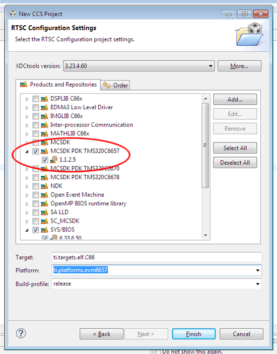

  • Hi Shuja,
    To tell CCS where ti/csl/csl_gpio.h exists, could you check the following RTSC Configuration dialog?  My understanding is we need to check PDK for the architecture.  (There is a different way to specify an include path, but I remember this worked fine.)
