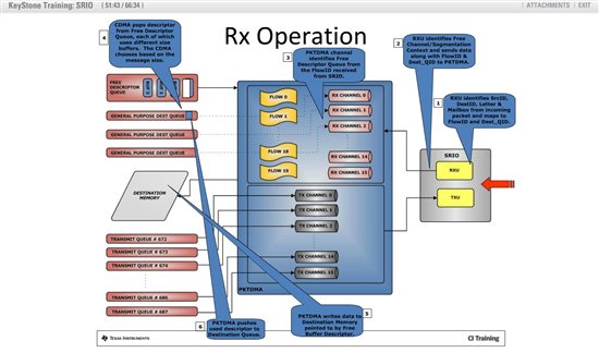

I have two questions concerning the SPRUGW1A user guide. 1) I am trying to understand the Message Passing RapidIO example code in sections 2.3.3.3.1 through 2.3.3.3.5 and cannot see the connection between Flow0 and DestID 0x5678. How is the SRIO peripheral being configured to route packets addressed to DestID 0x5678 to Flow0 [which uses queue 900]? 2) Can the INFO field in DOORBELL packet be used entirely and have the packet served by a single interrupt instead of indicating the doorbell register in the info field?
  • Igor,
    (1) Based on Mailbox, letter, source ID, and Destination ID the data is assigned the destination CPPI queue ID (QID) and flow ID.
    You can get more detail of SRIO operations and specifics at the training videos. http://focus.ti.com/docs/training/catalog/events/event.jhtml?sku=OLT110027
    This diagram was found in Serial RapidIO (SRIO).
    (2) I am not sure what you mean. Can you please clarify? I think you want to avoid using the INFO field to indicate which DOORBELL register interrupt bit to be set. If that is the case, then you can't do that.
