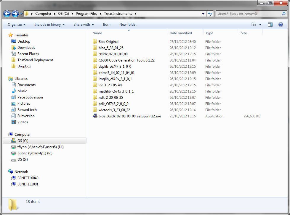

Hi Guys
I'm trying to get the example up and running that is located in the following folder:
C:\Program Files\Texas Instruments\pdk_C6748_2_0_0_0\biospsp_03_00_01_00\drivers\examples\evm6748\mmcsd_fatfs
I am running it on the 6748LCDK board.  It's all very well to have examples of peripheral operation but as a new developer to TI components the lack of documentation makes it difficult to get these projects up and running.  I have read the documentation and looked at the video located here:
C:\Program Files\Texas Instruments\pdk_C6748_2_0_0_0\biospsp_03_00_01_00\docs\C6748
And it makes no reference to the SD_FAT_fs example.  I tried to create the project as shown in the video but I cant seem to get it working in CSS.  All tools have been installed in the default locations suggested by the installer.  See the image below for my tool versions.
This is the CCS error I get:
Tony

           1. Verify the board you are using as the example your are trying to load is for evm C6748 but you have specified you are using LCDK C6748. If you are having LCDK C6748 use example that are specified for LCDK.
           2. The error message shows illegal pathname syntax.
              Verify the Path details in CCS
     Project ---> Properties ---> CCS General ---> RTSC ---> Other Repositries ---> Add the Repositries Path manually. (If you have problem in doing this rerun the video as its expalined there clearly on how to add)
