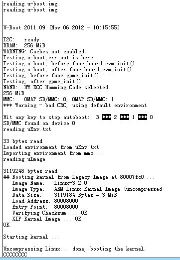

    Can you tell me what's the function with the pin of  VPP,  I connect the vpp pin to the 1.1v with core voltage together, the pins of VDDSH5 have 4.7V voltage output, I don,t know why, Do do you think the voltage outout from VDDSH5 pins because of this??  I had change 4 PCS am3359  on 4 boards,both of them had not connect the VPP pin to 1.1v, there is just one board change to OK , the vpp PIN don't have voltage output, the other threes board still have voltage output.I don't know why? can you help me?/
    The other question is that, the board which IS ok , the vpp PIN don't have voltage output, and the all voltage from tps65910aa1 is correct.  but the SYS conn't work,  we can't configura the PINS,  when it start  kernol,  THE boot will reset. do you knoe why??

    First of all your problem has nothing in common with this thread. In the future please post your questions on new threads.
    Toa nswer your question: VPP is a power supply input, which should be left unconnected. VDDSH5 pins are also power supply inputs, which should be supplied either from 1.8V or 3.3V. To see 4.7V on these pins means you have a serious problem with your board power supply, and changing the processor will not help. If you want we can do a schematic and/or layout review of your design. You can request a review through your local TI FAE/representative.
