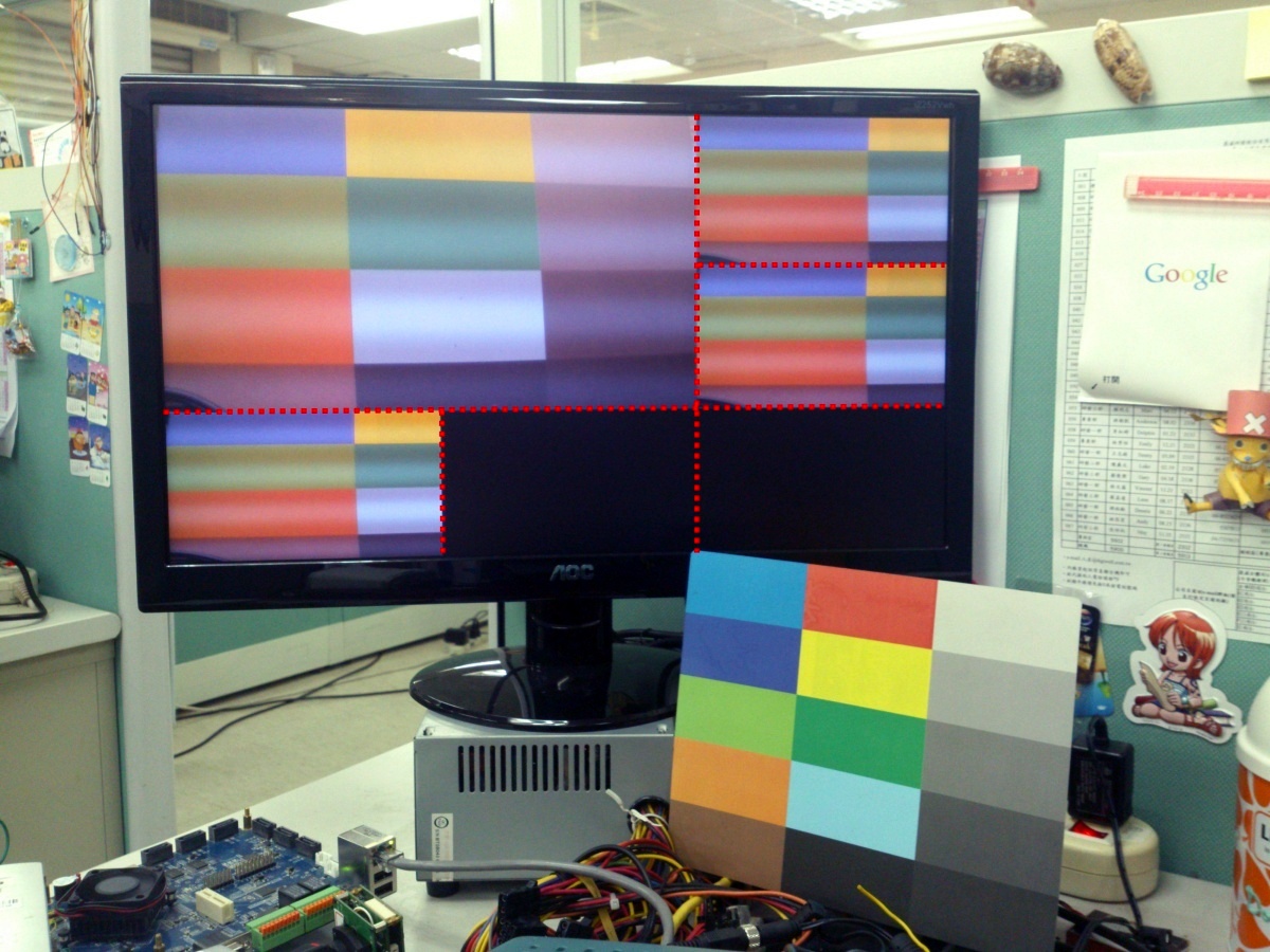

We encountered a problem and it looks like this problem relates to HDVPSS.
My usecase is
  • Capture: 8CH 1080i (1920*540)
  • Display: HDMI 1080p/60fps
As you can see in the first snapshot, it's OK when I display one of the eight channels.
As shown in 2nd and 3rd, obviously, certain part of the picture is lost (it looks like DM8168 VPSS cut the right part off but it's ok in height).
The RDK version is 3.0.1.3.
Thanks for your help.

  • Are you using PG1.1 Netra Silicon  ? If so max width can be only 960 when input is 422 . You can either migrate to PG2.0 netra silicon or use NSF link after capture to convert 422I to 420
  • Dear Badri,
    I am sure my silicon version is PG2.0. So it would not be an issue.

  • Can you try with the attached patch.Please update the following lines in HDVPSS package(hdvpss\hdvpss_01_00_01_37\packages\ti\psp\vps\core\src\vpscore_scWrbkPath.c)
    If issue is not resolved please share the full console logs starting from application start.

  • Dear Bradi,
    It works with the patch!
    Thanks again!
