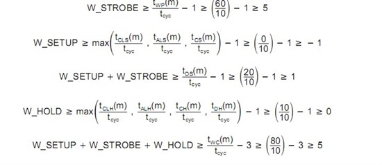

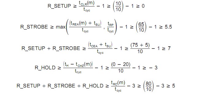

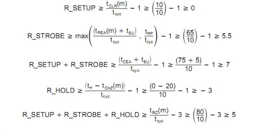

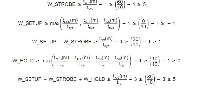

      I have use SAMSUNG K9K8G08 flash with am1808 soc. It boots up well and could saveenv in uboot. but it has problem when I mount it  to read or write .
I thought it must be something wrong with nand flash timing config.
     how can i config with  "struct davinci_aemif_timing da850_evm_nandflash_timing" ?

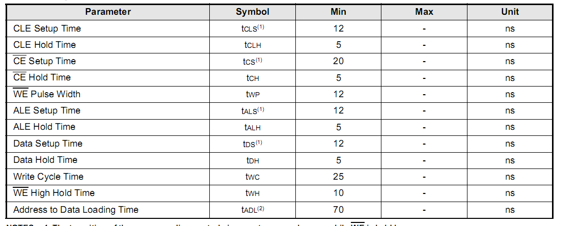

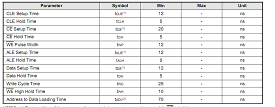

     here is the SAMSUNG K9K8G08 AC Timing Characteristics
how can i get the value of
.wsetup = ?,
.wstrobe = ?,
.whold = ?,
.rsetup = ?,
.rstrobe = ?,
.rhold = ?,
.ta = ?,
   thanks for your help .
