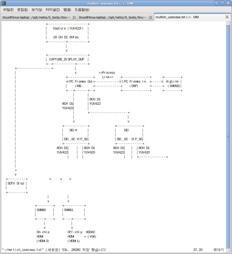

  • Are you seeeing the black dots in SD bypass path or not (Capture -> SDdisplay)
  • i saw the black dots in SDTV(1channel full) path. i use progressive usecase.
    Thanks.
  • SD bypass path does not go thru DEI as captured frames are directly fed to SD display.Are you sure you are seeing the issue in SD bypass and not in SD mosaic. If you see the issue with SD bypass it indicates video decoder(TVP 5158)  or cature source has the issue.
  • i use multich_progressive_vcap_venc_vdec_vdis usecase.
    according to the usecase diagram, capture_display_dup-> SDTV Disp.
    is it right capture_display_dup only work mem copy(duplication)?
    i think my usecase is SD bypass and not SD mosaic. in the progressive mode SD mosaic was not supported.
    do you think i check video decoder(we not using tvp5158).?
    i met video decoder FA. he told me that he saw similar screen in the hisilicon . it was memory timing issue.
    what do you think about memory timing check?
    Regards.
  • You are right progressive demo does not do SD mosaic.So SD display is just directly displaying captured image.Can you send a solid color and check if you still see the issue.
    If you see the issue even with solid color then you can dump the capture buffers are check the pixels corresponding to location where the black dots are seen.
    From the video you sent it looked like the issue is seen at edges of images.This seems unlikely that this is due to memory timing and more likely it is due to video decoder.Anyhow did you modify anything related to memory timing after which you are seeing this issue ? I assume you have confirmed there is no issue with the camera source by connecting camera to display directly .
