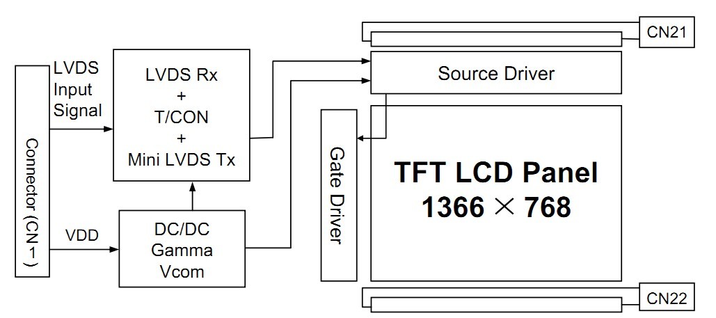

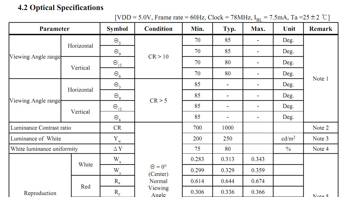

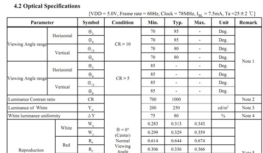

        I am working on Dm365 .We have made the 7 inch lcd with 800x680x24 RGB888 to work normally.   But now we want to  make  19'' LCD pannel to connect to Dm365 ,in order to don't  convert to  Dual pixel LVDS output for bigger then 19" LCD Panels .  We select  the HT185WX1-100 which is a 18.5''  & has a single  LVDS channel.It's features as following:
                                                           (picture 1)
                                                                    (picture 2)
                                                                             (picture 3)
as you know dm365 has single 24 bit digital video output, Now  I want to know dm365 whether support the HT185WX1-100 to work normally.
If dm365 can make HT185WX1-100  to work normally,what should i do?
