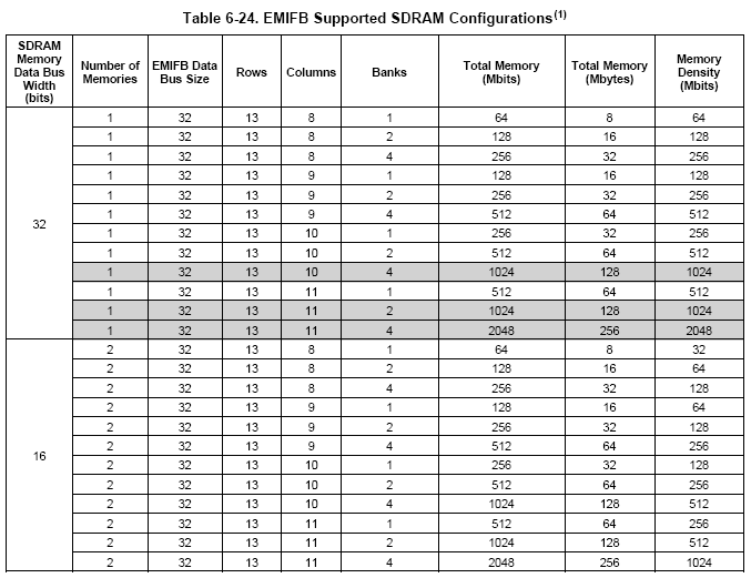

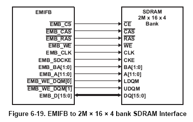

One issue,  I just want to use single 16bits SDRAM for my hew design,  connected  as this figure

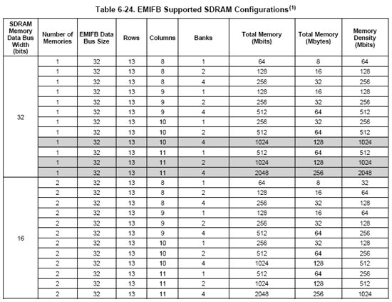

but I get the information  as  table 6-24 from the datasheet of 6745
It seems that 6745 just supports Dual 16bits SDRAM or single 32bits SDRAM.
So I want to confirm if single SDRAM for 6745 is OK?
Hope get your reply soon, thanks so much
