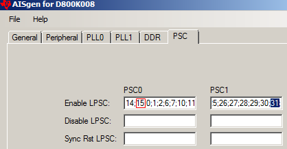

I followed http://processors.wiki.ti.com/index.php/Boot_Images_for_OMAP-L138 to boot DSP core from ARM. DSP LPSC (PSC0,#15) and PSC1.31 for shared_RAM have both been enabled (the explicit enabling of PSC1.31 in AISgen seems simply unnecessary and probably is redundant). Below are some basic settings:
AISgen version
1.9, for D800K008
DSP's entry_point
0x8000,0000
  1. In 128K shared RAM
  2. Aligned to 1KB boundaries
PSC
PSC0.15 for DSP core
PSC1.31 for 128K shared RAM
ARM & DSP memory placement overlap
No

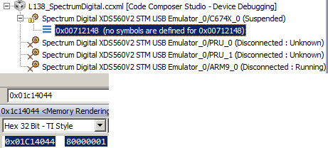

  2. For all times after the few exceptions in (1) later, I never had the luck to see DSP booting successfully from the snippets above again. In these cases, I connect to the DSP with XDS560V2 and see its PC at 0x007?????, by referring to “2.5 Memory Map Summary” of SPRS586C I see that this address is in the 1024K DSP L2 ROM.  Reading of SYSCFG0.HOST1CFG show that “DSP boot address vector” is at one byte (=0x8000,0001) after the set 0x80000000 address and I have no idea if it should be exactly 0x80000000 and the 1 byte difference suggest some error. We also checked 128K shared RAM, memory inside DSP’s megamodule and DDR2 and found that all contents listed in the .map file has been correctly loaded.

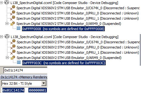

    1. If we connect to ARM with XDS560V2, we see ARM PC at 0xFFFF???? which is in ARM’s local ROM.
    2. We also see that at address 0x01c14174 CHIPSIG[0] signal has been asserted.

  • Without the leading “Disable DSP->Assert reset”, the latter enabling/reset operation is not effective, and our screenshot above has shown that the DSP’s PC incorrectly points to DSP L2 ROM. What is the content there? If there are legal instructions inside DSP L2 ROM, Would the seeming aimless and random execution of instructions corrupt the memory region, either in the 128K shared RAM or DDR2, that the ARM is going to use?

    I didn't get time to go through the complete description. From a high level, I can clarify couple of things for you.
    1. When you are seeing DSP in suspended state at the addres 0x0071_2148 can you try to reset the core alone by doing a "Run->Reset->CPU reset".
    2. After the reset, try to load your DSP executable there and run. See whether your algorithm runs fine or not.
    3. Also make sure that you are setting the exact start address of the DSP binary, in the "DSP boot address vector".
    Regarding ARM
    1. The exception vector that you are seeing 0xFFFF_0008 is Software interrupt vector and not IRQ. I don't see any chance of getting a SWI unless you are making a system call or an explicit SWI instruction execution. Most likely, it might be because undefined instruction or reset exception (0xFFFF_0004 or 0xFFFF_0000) and there is no proper handler at these addresses. Because of this it might continue executing the next instructions.
    2. To confirm what happened in ARM, you can read the CPSR register and check the current ARM mode.
    I'll check the description in detail, when I'm free and update you. Meanwhile you cross check these info.

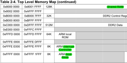

    I would like to know why you suggest that 0xFFFF_0008 is the address of SWI? According to memory map at SPRS586C this address is within ARM's 8K local RAM, and although I do have SWI handlers and did (and still to this day) call the SWI handler to switch ARM into system mode (PSR [4:0] = 11111), this SWI is placed in the shared 128K IRAM at address 0x80000000.
    Paul
  • Paul,
    ARM's(ARMv5 or less) exception vectors will have only two possible locations. Either starting from 0x0 - 0x1c or high vectors 0xFFFF_0000 -> 0xFFFF_001C. If you are running a HLOS (Linux) then they'll enable high-vectors to map the exception vectors to kernel address space.
    Since you've shown in the CCS snapshot where ARM is suspended at the address 0xFFFF_0008, I assumed that high vectors is enabled in your case. That's how I made the statement.
