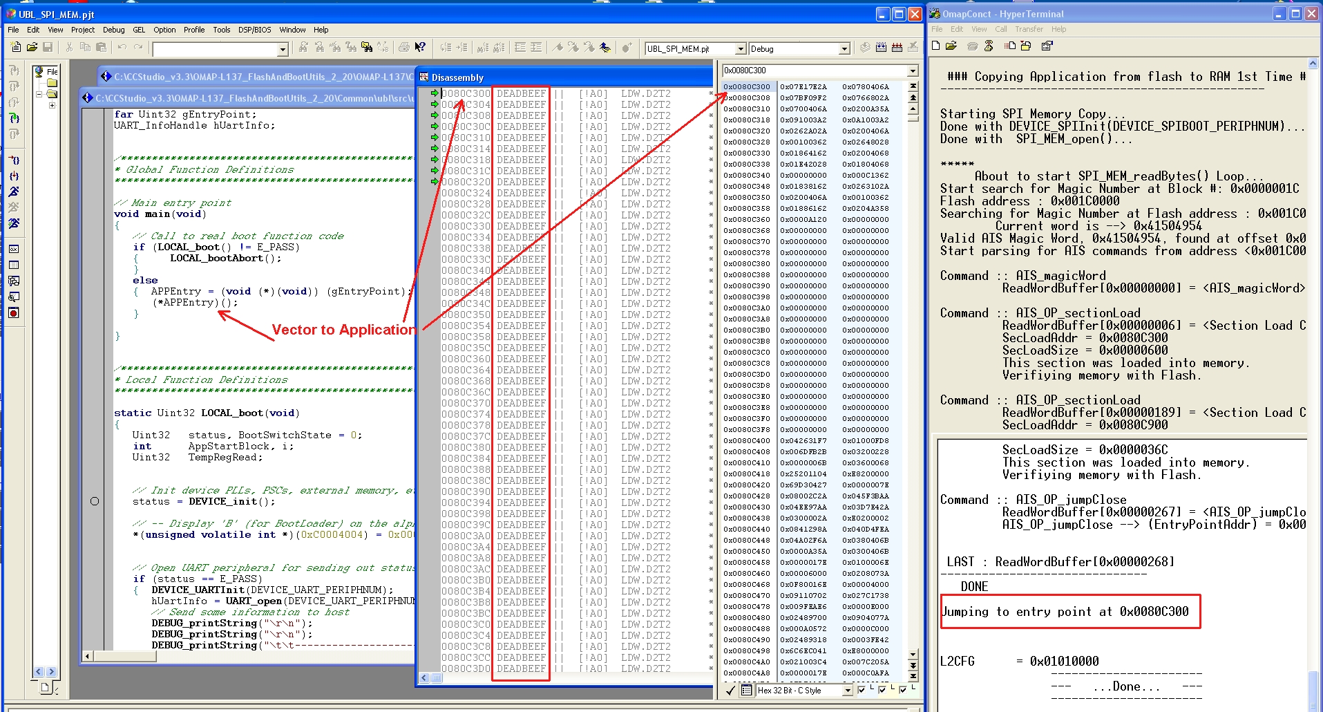

  • I did spend some time with the debugger and it turned up something rather strange. I'm not sure if it was a debugger limitation or it points to my actual problem.
    In my first email I mentioned that "if I initialize an area of DSP_RAM (load it with zero or DEADBEEF), loading the application there will always cause the system to hang".
    To clarify this a bit, if the UBL initializes all L2-RAM to zeros. It then loads the app into L2-RAM and vectors there. The debugger will show this area of L2-RAM as zeros (NOPs) but a CCS memory window shows the correct application code in those same memory location. Is this a memory protection problem or a user level problem? Both MPUs are set for ASSUME_IS_ALLOWED.
  • I am going to re-visit this and send you a screen-shot (JPG).
  • OK, this is what I get if I run the UBL in debugger. This is a UBL that first sets all L2-RAM locations to "0xDEADBEEF" then later copies the application into L2-RAM. The app entry-point is 0x0080C300. Notice that the disassembler shows the L2-RAM as "0xDEADBEEF" while the memory window shows the correct application code values.I am thinking that this is somehow pointing to the source of my problem. The application has been correctly copied into L2-RAM but after the jump, the state of the processor sees what I am seeing in the disassembler window.
  • Might be CCS IDE bug. The two windows are unsync'ed or not refreshed? Maybe add some code to verify the copy or test for 0xDEADBEEF. My examples do not touch the L2 config registers. Which I think means that L2 RAM is not used as cache. That's all I got.
  • That is true. The L137 and C6747 power up with L2 set as RAM not cache so there is no need to touch config registers.
    My UBL does verify memory after copying the Application from Flash to L2-RAM so I know the memory window is correct (as far as what is in L2-RAM). However, the disassembler window seems to be showing exactly what the processor is executing (even when I don't step through in debug mode).
