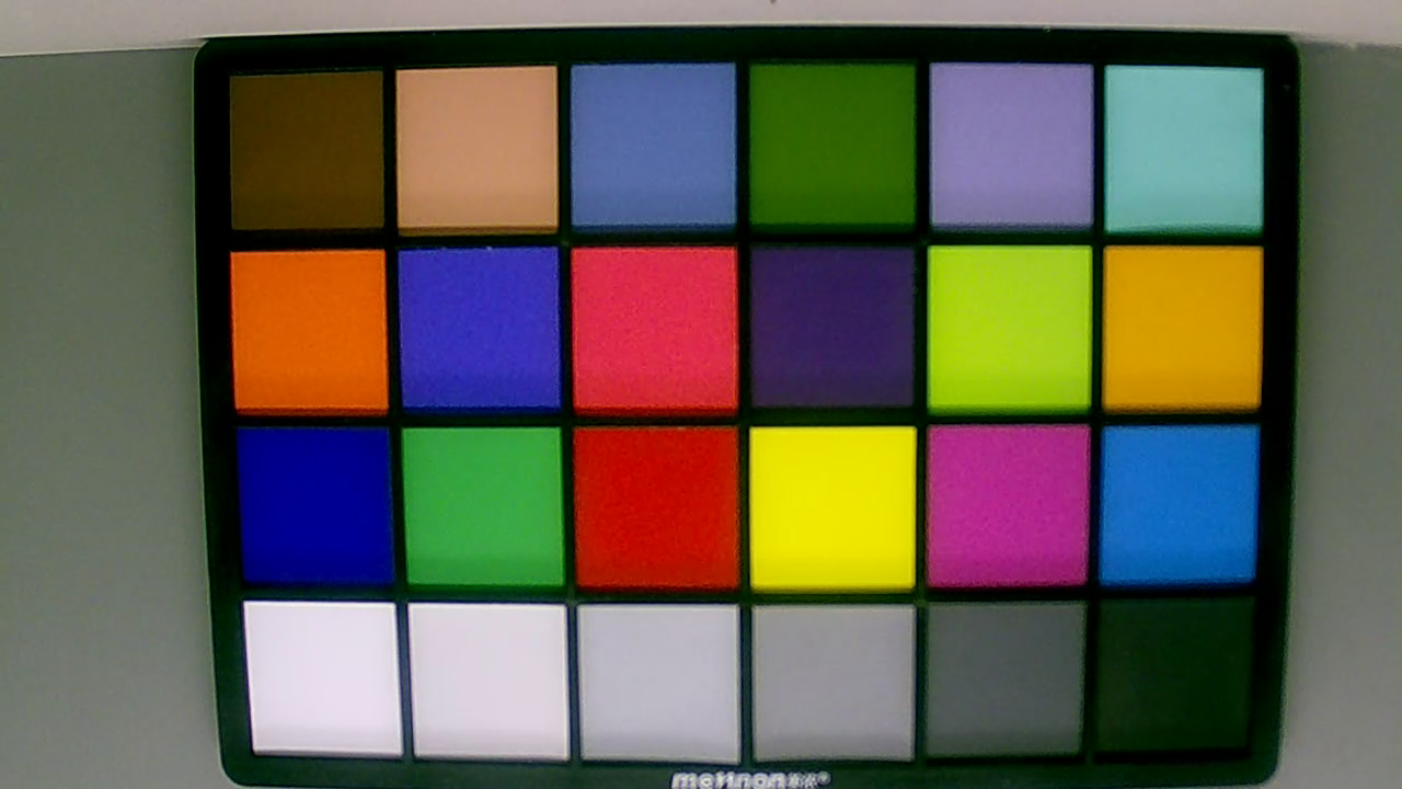

Hello everyone, at first I use the TI  EVM with the sensor of MT9P031. Now I want to change the sensor to OV9712. I just change the sensor driver program as the AVServer_DesignGuide_IPNC_DM36x.pdf says.  Now I can see the image through VLC. I have the 24CheckColorI and standart light box by hand.

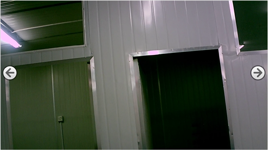

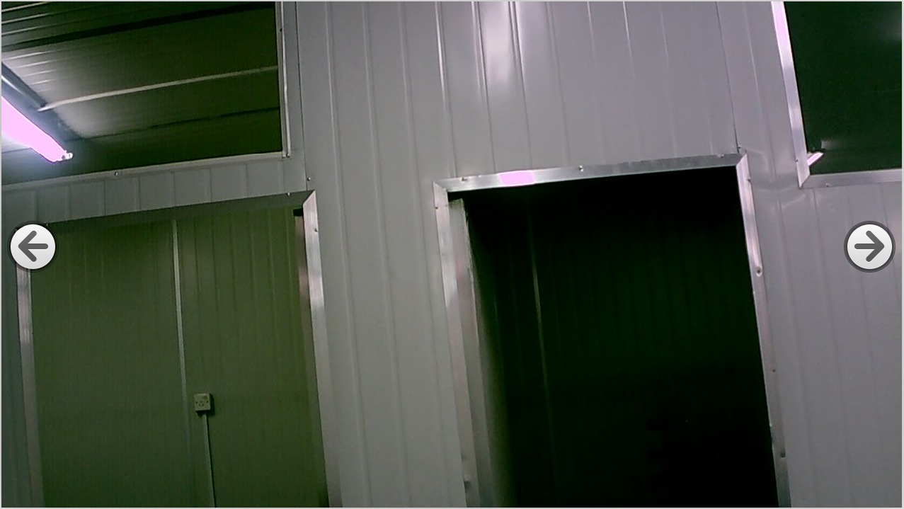

I tuning Ov9712 using the tool DM36xImageTuningTool. I only do AEWB and Collor correction with this tool. Now I have questions as follows:
1.The bright area is normal But the dark area of the image is a little green
2.If the area of the scene is a little dark ,the image of the same area is darker than it actural is.
The attachment can show the problems.
Who can help me what is the matter?
Is it because the Collor Correction Matrix is not acute or something else? I didn't change the Gamma table which is designed  for MT9P031  originally.
Do I need to change the Gamma table specifically for the OV9712 ?
