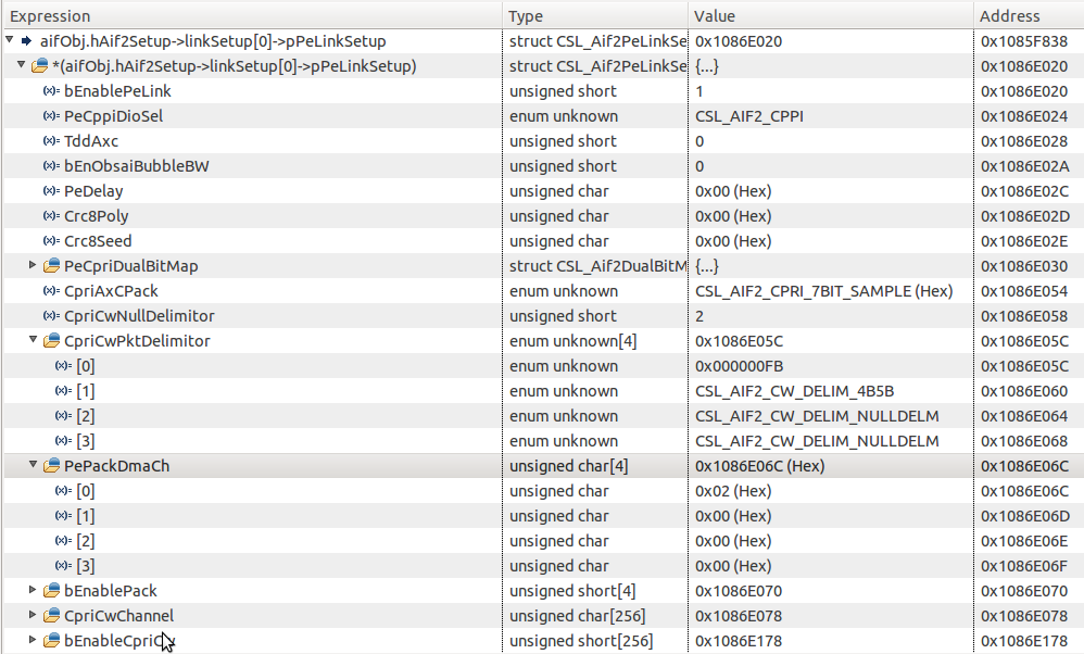

we try to recieve CPRI C&M from AIF2 with PktDma.
Inside of our Test C&M data we use a counter from 0x00 to 0xFF.
So normally the Delimiter value 0xFB is omitted. The result is that the Packet length is 1020 Bytes instead of 1024 Bytes (4x CPRI Rate).
We tried to configure Packet Boundaries on hyper-frame boundaries with:
        aifObj.hAif2Setup->linkSetup[0]->pPdLinkSetup->CpriCwPktDelimitor[0] = CSL_AIF2_CW_DELIM_HYP_FRM;
But this results in a Packet length of 0 Bytes.
This is a behaviour we have not expected !
Who can help?

    We tried with the provides LLD but it didn't work. Further inspections showed,
    that the PE LinkSetup seems to be faulty.
    In the attached picture you can see the CSL_Aif2PeLinkSetup right after  the
    AIF_initHw() call.  The values are shifted, such as CpriAxCPack should have the
    value of CpriCwNullDelimitor, CpriCwNullDelimitor should have the value of
    CpriCwPktDelimitor[0] and so on.
    Are we missing a struct member in our setup, which could cause this behaviour?
    Kind regards
    It looks like I used a more recent AIF2 csl to generate the 1.0.0.8 package, hence the misalignment for the CpriCwNullDelimitor.
    One way to solve that to rebuild the AIF2 LLD within your PDK environment.
    Open a command prompt and go to <pdk_install_path>\ti\drv. Then call pdksetupenv.bat, and rebuild the AIF2 LLD:
    gmake -C aif2       LIBDIR=./lib clean
    gmake -C aif2       LIBDIR=./lib all
    Please tell me how it does.
    Best Rgds/Seb.
  • Hi Seb,
    thanks for your reply. After recompilation of the AIF2 LLD, the structs were
    filled with the expected values and the we could successfully run the cprifastcm
    test.
