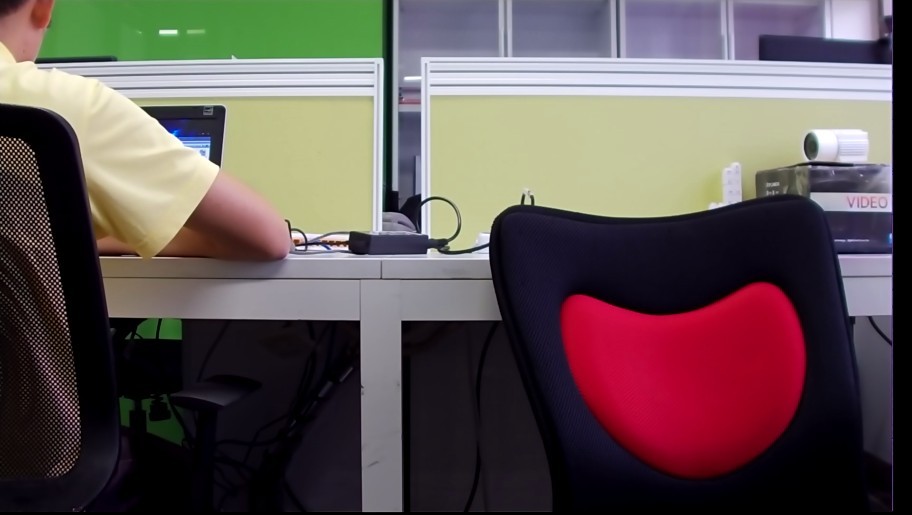

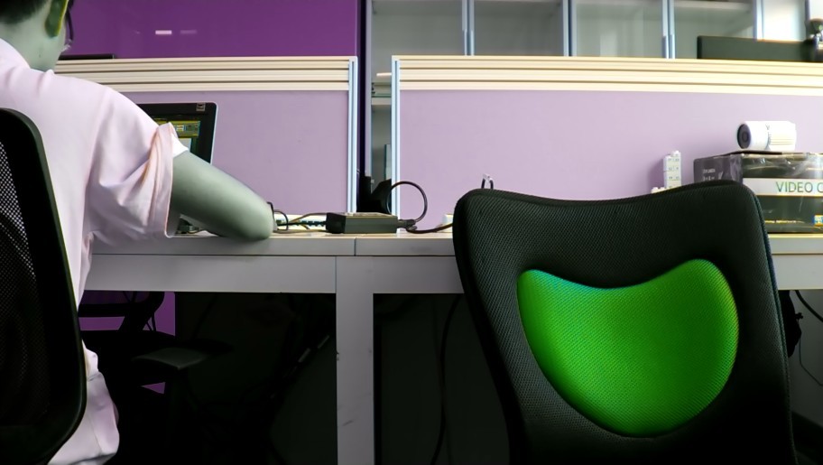

    2,I use the dm8127,and chang the sensor to MN34041.display is:
    but the normal is :
     i think the color pattern is erro.so i find the SRC_COL register,and chang it ,but it still incorrect.and i have no reference to describ the register.
    so could you tell me how chang the color pattern?
    hope for you answer,thank you!
  • above lost the incorrect picture:
