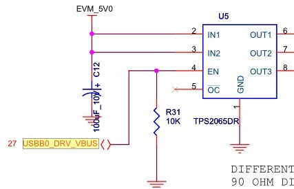

    I test USB interface on custom board  is not work, Mistral board is work normal,. According to Mistral board's circuit design. I test level through multimeter.
The result is the pins of 2 and 3 is 5V, but The pin 4 is still low level, so the pins of 6,7and 8 is still low level, this cause USB not work normal.

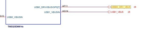

The normal condition is the pins 4,6,7,and 8 is 5V.  So,I want to konw USBB0_DRV_VBUS is controled by what, and find that:
As the over illustration, this level is controled by A8.

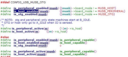

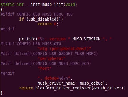

I want to pulled USBB0_DRV_VBUS signal high levle in linux kernel to test that whether the signal is 5V?But I cannot find the control function is linux kernel.May I idea is right? Can you tell me the contorl funtion in which directory?
