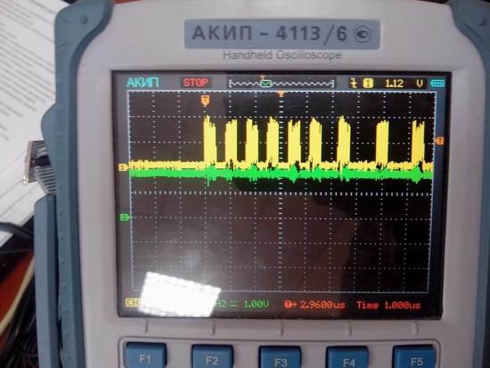

When DM3730 reads data from FPGA, an unpredictable delay between bursts appears.
Please look at photo: why delays are so large? Why they are different? Every burst is correct.
Yellow line is GPMC_CLK.
  • Is it because of the OMAP_DMA_SYNC_FRAME parameter? Can you share a snapshot of the interface schematic between the DM3730 and FPGA? Do you have a FIFO inside the FPGA, and what is the depth of the FIFO if available?
  • > Is it because of the OMAP_DMA_SYNC_FRAME parameter?
    I don't think so... Frame size = 64 bursts, so SYNC_FRAME should not affect the delay between bursts.
    FPGA connected right to the GPMC lines, without any resistors or integrated circuits. But there is Ethernet and NAND connected to GPMC too... We are using TDM3730 with Blizzard board from Technexion ( http://www.technexion.com/index.php/support/download-center/arm-cpu-modules/tdm-3730 ).
    Yes, we have a FIFO, size = 64*8*2 bytes (exactly 64 bursts * 8 words in burst * 2bytes in word)
    ...and we are not using WAIT pin.
  • Are the other devices on the gpmc asynchronous or synchronous?  If they are asynchronous then your scope would not trigger since there would be no clock. Perhaps the gaps are simply transfers to the other chip selects.
  • NAND is asynchronous. Now we have checked CS pins of other devices, and they are not active.
    I guess we can get around this problem by using maximum burst size, but i'm not sure this is the right decision...

    Can you try with OMAP_DMA_SYNC_BLOCK instead of OMAP_DMA_SYNC_FRAME. Basically it will raise and interrupt/event when each and every frame is completed.
  • Initially, we did a frame on one element and OMAP_DMA_SYNC_BLOCK after 64 frames. And the delay time was little more than now (~10%).
    Now we have one big frame.
    UPDATE: OMAP_DMA_SYNC_FRAME to OMAP_DMA_SYNC_BLOCK change had no effect on delays between bursts for one big frame.
