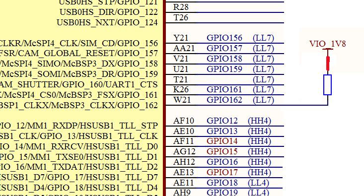

  • Hello Cvetolin,
    The OMAP3530 GPIO162 pin W21 (package CBB) is connected to an external pull-up (PU)  resistor connected to 1V8 OMAP vdds power domain - see image attached.
    We did set-up this test in order to have no other effect than the external PU on the pin (same power domain, no extra load).
    The GPIO162 is configured as Output - therefore the internal PD is opposite the external P only before the pad is set to Output.
    For the transient time between the OMAP power-on state and the GPIO162 set as output - the internal PD oppose the external PU connected.
    We recorded the voltage at the GPIO162 with an oscilloscope - it is 0.5V with ext. PU 10K and 0.86V with ext. PU 4K7.

  • Hi Tsvetolin,
    We are interested by the logic level of GPIO configured as Output during the Power-ON to GPIO output being active.
    This is required for having the correct logic level at start and not a toggle during few 100ms.
    You will find attached an oscilloscope snpshot of this transient time.
    The time of interest is where the voltage is 0.86 V, afterwards the output is active and the level immediately at 1V8 power domain.
    I hope this helps.
    Francois Arnaud
