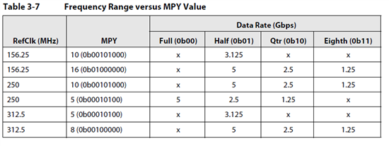

    The PLL VCO is the Ref. Clock * MPY. The PLL VCO should be within the nominal range 1.5625 - 3.126 GHz so that confuses me why a MPY with 5 does not work when using a Ref. Clock of 156.25 MHz.
    Please explain how you see that the PLL is locked and then becomes unlocked.
    Frederick,
    A line rate of .78125 is not even acceptable. You should be only using 5, 3.125, 2.5, or 1.25 Gbps line rates. Can you explain these tests that pass/fail in your different testing environments?

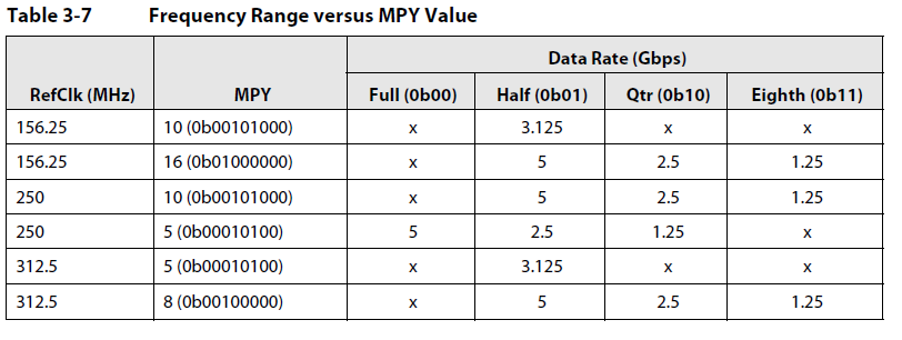

    Make sure to follow this table in the SRIO UG (updated in December 2012)
    The 156.25 MHz ref. clock with MPY 5 is not even valid. Can you raise your ref clk?
