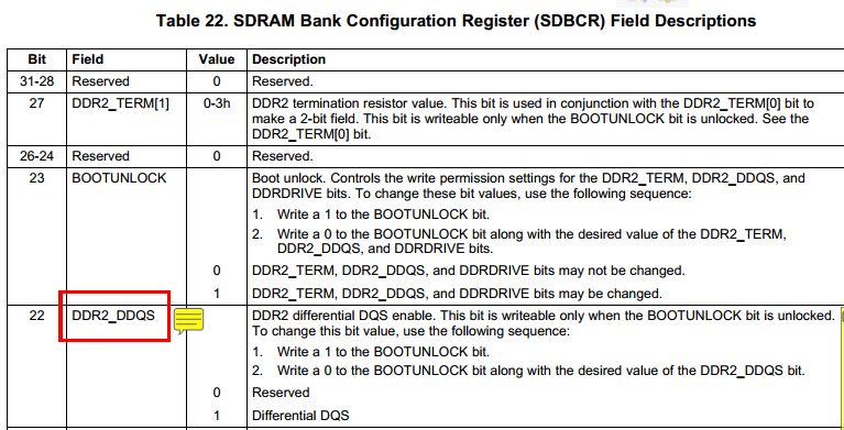

  • Thanks for you reply, the problem has been solved, which come from the wrong configuration of GEL with DDR.
    The DDR2_DDQS bit of SDRAM Bank Configuration Register (SDBCR)  must set 0 on my board.
    Here is my GEL configuration:
    setup_ddr2( int freq )
    DDR_DDRPHYCR = 0x00008AC5;
    DDR_SDBCR |= 0x00800000;
    DDR_SDBCR &= ~0x00C00000;
    DDR_SDBCR |= 0x00008000;
    ...DDR_SDTIMR configuration...
    DDR_SDBCR = 0x0013C832;
    DDR_SDBCR = 0x00134832;
