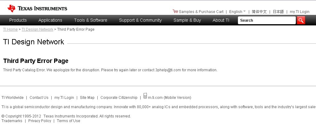

Sorry,clicking the link http://www.ti.com/devnet/docs/catalog/thirdpartydevtoolfolder.tsp?actionPerformed=productFolder&productId=8517 will appear the following page,I have not played any sound successfully via headset yet.
