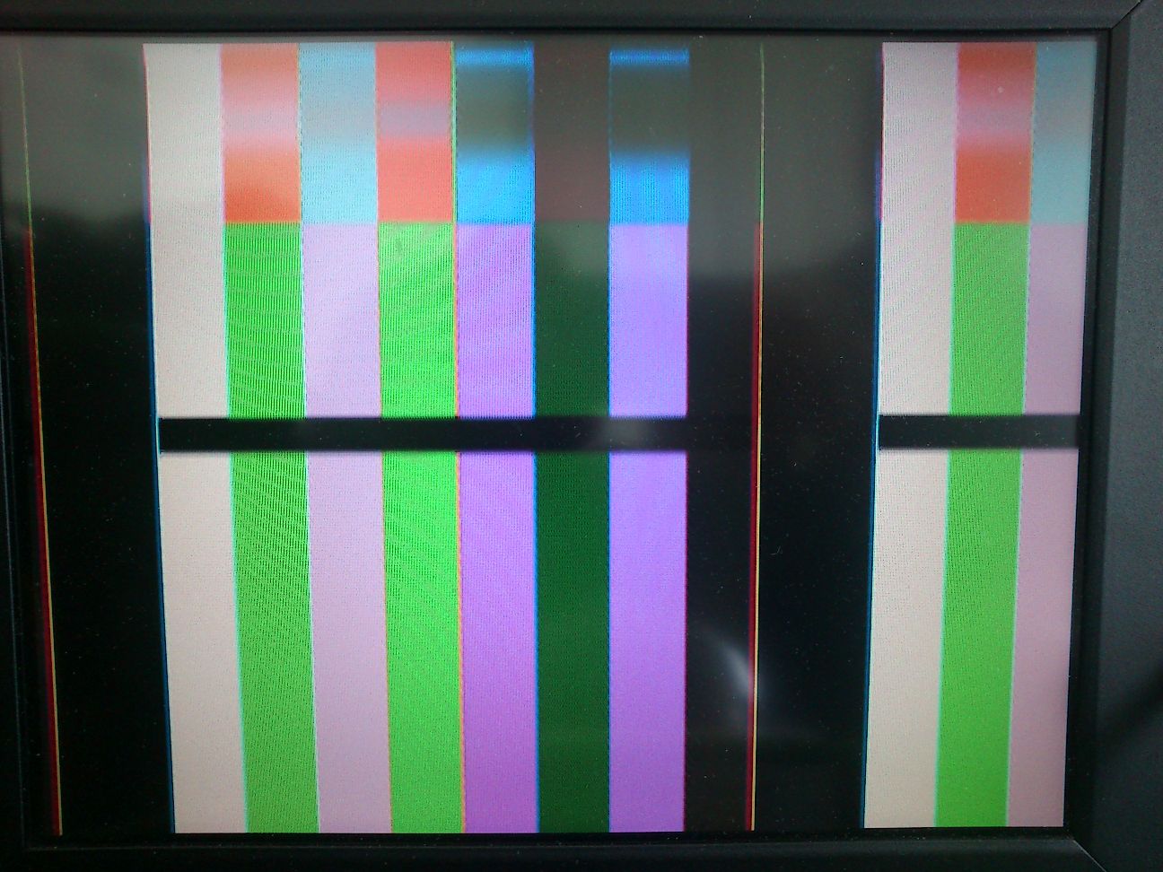

  • Currently we do a rework of our DM8168 based system.
    The system is based on Udworks design and DVRRDK 03.00.00.00.
    We try to use SAA7129 on DV02 for a second CVBS video output.
    The DV02 is tied to HDCOMP.
    Output format of DV02 and HDCOMP is 720x576 progressive.
    I get some problems with SAA7129 to encode PAL from progressive
    input to interlaced output.
    One solution may be to set 720x576 interlaced output to DV02.
    Is it possible to use the changes from Shiju Sivasankaran to achieve
    this in DVRRDK 03.00.00.00 ?
  • Ok, I have added the changes, but I am not sure what is to be modified for DVO2 for PAL 720x576@30..
    We have tied HDCOMP to DVO2, the external encoder SAA7129 is connected to DVO2.
    What else is to do to get interlaced PAL at DVO2 ?

  • The problem seems to be another.
    SAA7129 expects a clock of 27 MHz.
    But the timing setting for interlaced PAL is:
    VDIS_TIMINGS_PAL "216000,720/16/58/64,576/6/31/6,0"
    In progressive mode I can see colorbars but the colors are not right and the bars
    are 2 times in a frame.
    In this case we use:
    VDIS_TIMINGS_576P  "27000,720/12/68/64,576/5/39/5,1"
  • In progressive mode, pixel clock should be set to 54MHz and it should be in bt1120 mode.
    In interlaced mode, can you try below timings?
    VDIS_TIMINGS_576P  "27000,720/12/69/63,576/2/19/3,1"
    Brijesh
  • PFA snapshots of DVO2 colorbars interlaced and progessive mode via SAA7129. I have used the following values: #define VDIS_TIMINGS_PAL        "27000,720/12/69/63,576/2/19/3,0" and #define VDIS_TIMINGS_576P       "27000,720/12/69/63,576/2/19/3,1"
    Another problem is, that I can not initialize the following: vdisParams.deviceParams[VDIS_DEV_HDCOMP].resolution = VSYS_STD_PAL; Vdis_tiedVencInit(VDIS_DEV_HDCOMP, VDIS_DEV_DVO2, &vdisParams); In this case I get no clock at DVO2.
    instead I use: vdisParams.deviceParams[VDIS_DEV_HDCOMP].resolution = VSYS_STD_1080P_60; and later I set the resolution to VSYS_STD_PAL.
    Interlaced:
    Progressive:
  • I have some questions:
    1.)
    Is it possible to use PAL 576p resolution in VDIS_DVOFMT_SINGLECHAN mode ?
    I did read that only 16/24 bit mode is supported in this case.
    This would force us to use interlaced mode for SAA7129 because it is connected via 8 bit.
    2.)
    I have added some debug trace to watch if the patch for vpshal_hdvenc.c does work.
    Interlaced mode for DVO2 seems no work now in my hdvpss.
    I could see that the following part was not executed:
     if (FVID2_STD_PAL == vencCfg->hdVencMode)
                *(volatile unsigned int *)0x48100114 = 0x8000E;
                regsOvly->CFG1 = 0x003F0275u;
                regsOvly->CFG2 = 0x1EA500BBu;
                regsOvly->CFG3 = 0x1F9901C2u;
                regsOvly->CFG4 = 0x1FD71E67u;
                regsOvly->CFG5 = 0x304001C2u;
                regsOvly->CFG6 = 0xFF200200u;
                regsOvly->CFG7 = 0x1B6C0B35u;
                regsOvly->CFG8 = 0x1C0C0C30u;
                regsOvly->CFG9 = 0x1C0C0C30u;
                regsOvly->CFG10 = 0x00271360u;
                regsOvly->CFG11 = 0x3F150018u;
                regsOvly->CFG12 = 0x3F2D0089u;
                regsOvly->CFG13 = 0x00000139u;
                regsOvly->CFG14 = 0x0003F32Du;
                regsOvly->CFG15 = 0x042D008Au;
                regsOvly->CFG16 = 0x00019008u;
                regsOvly->CFG17 = 0x01120151u;
                regsOvly->CFG18 = 0x01001120u;
                regsOvly->CFG19 = 0x0100213Au;
                regsOvly->CFG20 = 0x0013913Bu;
                regsOvly->CFG21 = 0x042D0082u;
                regsOvly->CFG22 = 0x00019008u;
                regsOvly->CFG23 = 0x01120152u;
                regsOvly->CFG24 = 0x01001120u;
                regsOvly->CFG25 = 0x0100013Au;
    If I force the execution - than I get problems when we want to access I2C.
     *(volatile unsigned int *)0x48100114 = 0x8000E; is the reason for this.
    Is this register OK for DM8168 ?
    Best regards
    Holger
    0x48100114 is a HDVPSS register, it should not at all affect I2C. This register settings are correct and validated by other customers, instead of trying with complete dvr-rdk, can you try with the hdvpss first and see if it works fine.
    Regarding color bar, it looks like height is getting programmed correctly, i will relook into settings.
    Rgds,
    Brijesh

    To be safe I applied the patch to vpshal_hdvenc.c from version hdvpss_01_00_00_01_36. Otherwise I use version hdvpss_01_00_00_01_37_patched from DVRRDK 03.00.00.00. and added the patch manually.
    The behavior currently is as following:
    if *(volatile unsigned int *)0x48100114 = 0x8000E; is executed in vpshal_hdvenc.c than we do not have 27 MHz clock at VOUT0_CLK. In this case the 27 MHz clock only occurs if I set vdisParams.deviceParams[VDIS_DEV_HDCOMP].resolution = VSYS_STD_1080P_60; and later during initialization I change the format to VSYS_STD_PAL.
    The color bars are visible 4 times in the display, (if I show OSD it is better visible that the display contains the same 4 times like in a 2x2 mosaic).
    Initialization seems to be ok, but a warning occurs "[m3vpss ] PLATFORM: UNKNOWN CPU detected, defaulting to VPS_PLATFORM_CPU_REV_2_0" (attached teraterm.log).

  • To verify that SAA7129 works correct, we disconnected SAA7129 from DM8168 DVO2 and connected an external video device via the 8-bit data bus to SAA7129.
    We inserted video data and 27 MHz clock. Interlaced PAL video output from SAA7129 works fine in this case.
    Settings of the SAA7129 encoder are OK.
    Now we will reconnect SAA7129 to DM8168 DVO2 and go on solving the problem.
  • I have got the PAL interlaced video output via DVO2 and SAA7129 working. For testing purpose I went back to the demo version DVRRDK_03.00.00.00. With original usecase multich_progressive_vcap_venc_vdec_vdis and with a display combination HDMI/HDCOM/SD-Bypaß I can tie HDCOMP and DVO2. The patch works and PAL interlaced is OK via SAA7129.
    In our modified usecase we can select 3 display combination (each combination with 2 independent mosics).
    1. HDMI / SD
    2. HDCOMP / SD
    3. HDMI / HDCOMP /SD-Bypass
    Our goal is to get the following display / mosaic combinations:
    1. HDMI (1920x1080) / SD (720x576)
    2. HDCOMP tied DVO2->SAA7129 (720x576) / SD (720x576)
    I did try  HDCOMP tied DVO2->SAA7129 / SD combination without success, that is the reason why I went back to the former original demo.
  • Last but not least I have video output running in both variants.
    HDMI + SD and SD + SD via SAA7129 can be selected in initialization.
    Thanks for the patch, thanks for the support.
