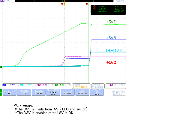

    Hello ,  Michi  asked me to talk about workaround with customer
    I had asked customer to change the power sequence to  change 3.3V comes last after 1.8V is OK.
    Below is the  result of  customer's work around.
    How do you think this chart?  ( Customer hope to get your approval)
