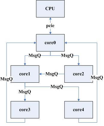

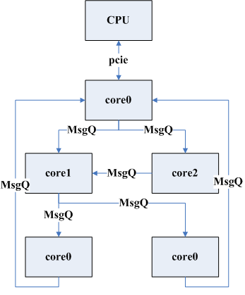

hi,I met a problem with c6678.I use MessageQ to transfer data with 8 cores
but there is always a bug when the program run a long time.That is

I use the MessageQ API like this:
MessageQ_alloc-->MessageQ_put
MessageQ_get-->MessageQ_free
I dont know what mistake I made?
the program can run 1442min,then it report error
sometimes it report MessageQ alloc error,but sometimes it report nothing,just like breakdown
i try to use emulator to debug the program, but i just can debug the core0.If i connect all the 8 cores and load the program,then run it,it doesnt work
please help me,ths

    Then I follow ur advices to verify every MessageQ Buf and Address.I found sometimes the program used a buf that had been sent to another core.
    It is really hard to find the memory address error that cost my plenty of time cause I have to run the program over 1000min.I am so lucky to find it.
    It means that two cores use the same memory address at the same time!
    I hope it is the right reason that the program crashes.
