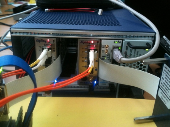

Help me! DSP to DSP CPRI TEST
hi all,
Test is well below the source to the DSP within.

Am trying CPRI test between DSP to, but I can not do it.
Answer?
Test board AMC-2C66-3AIF Card
http://www.commagility.com/amc-2c6670.php
Best Regards
gyosun
  • Gyosun,
    Can you start by indicating where the failure occurs.  Right now, there is very little information that you've provided regarding what you're doing?  Please go step by step what's you're doing, and what are the indications of failure.
    Chad
    AIF2 DSP to DSP intercommunication requires external sync input for both DSPs on your boards. you need to create common physync and radsync pulse for both AIF2. you also need to change the AT sync input selection to AtCommonSetup.PhySyncSel = CSL_AIF2_CHIP_INPUT_SYNC;
       AtCommonSetup.RadSyncSel = CSL_AIF2_CHIP_INPUT_SYNC; like you did for RP01 timing option.
    try that and let me know your result.
    Albert
  • Thank All
    # define DEBUG_NON_RP1_TIMING 0
    Changes little while there is no change.
    Under the slave-side code.

    Development environment are as follows.
    Left side : AMC Card #1, Master , Link2 SFP+
    Right side : AMC Card #2, Slave , Link2 SFP+
    Connection Master Link2 Tx -> Slave Link2 Rx
    Connection Master Link2 Rx <- Slave Link2 Tx
    Final goal LTE 20MHz 8x link CPRI test between the two boards, I'm not sure how.
    Thank you for your help.
    Thank & Best Regards.
    gyosun
