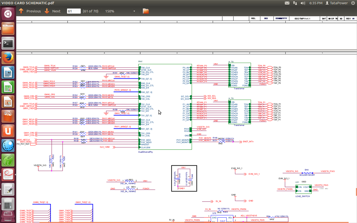

  • Hi Paul,
    I am working on custom DM8168 board and have VSC8502 dual PHY, i got  phy_id 0x18 and also applied your patch for 1 GIG but not able to ping,
    By using the mii command getting the dump value as :
    TataPower8168_EVM#mii device
    MII devices: 'GENERIC @ 0x18'
    Current device: 'GENERIC @ 0x18'

    My PHY link is up (LINK = 1000000) on u-boot, Fails to ping,
    Any configuration need to write for VSC8502 Dual PHY, Please help me resolve the issue.
    Also find the our design in the attachment.
    Vidya
