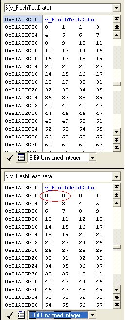

I'm using PSP 1_10_03 with DM6437 and want to read data from SPI Flash (ST microelectronics M25P32).
First a SPI flash sector is erased and a new set of data is written into it, but when a data is Read back from that Sector it is inconsistent to the data written to the SPI FLash. It looks like the first two bytes are incorrect and after that all the data comes properly.

  • One of the solutions it to reset the SPI Receiver before retriving the data from SPI flash device.
    SPCR regiser bit0  (RRST - receiver reset) -> 0 'Reset' and than write 1 'Enable' Receiver.
    /* (RRST) bit in SPCR to 0. - Reset Receiver */
      CSL_FINST(mcbspRegs->SPCR,MCBSP_SPCR_RRST,DISABLE);
      waitloop(0x20u);
      CSL_FINST(mcbspRegs->SPCR,MCBSP_SPCR_RRST,ENABLE);
      waitloop(0x20u);
